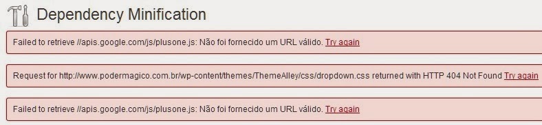

    OK – Updated minify to Version 0.9.4 now same pages give the same “try again” error.
    Dependency Minification
    Today appears this:
    Warning: Invalid argument supplied for foreach() in /home/podermag/public_html/wp-content/plugins/dependency-minification/dependency-minification.php on line 253
    Warning: Cannot modify header information – headers already sent by (output started at /home/podermag/public_html/wp-content/plugins/dependency-minification/dependency-minification.php:253) in /home/podermag/public_html/wp-includes/pluggable.php on line 899
    http://3.bp.blogspot.com/-JypMA7A7xMo/Upel8uAHHwI/AAAAAAAABbc/sNQuOvrSW6Y/s1600/DepM.jpg
    Please, can you help me?
    Thanks a lot
    Cheers
    Aurelio Martuscelli
    [Moderator Note: Please ensure that you are embedding links correctly in your posts.]
