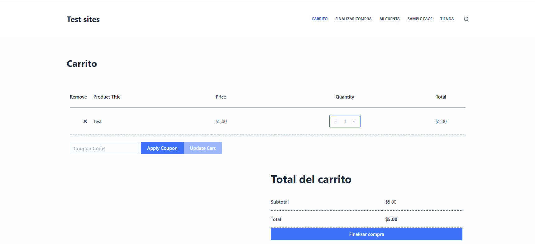

    I upgraded my elementor site to the new flexbox containers, however I am having styling issues when using the woocommece shortcodes on pages with flexbox containers.
    In some cases it modifies the colors and in others the borders.
    I share the following sample images:
    1. Image of the cart page created by default in woocommerce.
      2. Image with woocommerce cart shortcode in a flexbox container.
      This same problem occurs with the other woocommerce shortcodes.
      I remain attentive to your comments.

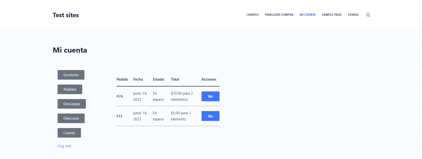

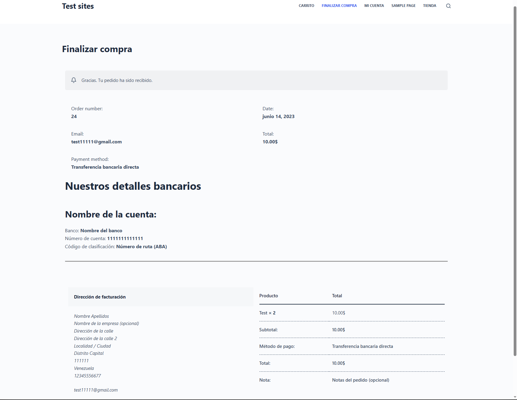

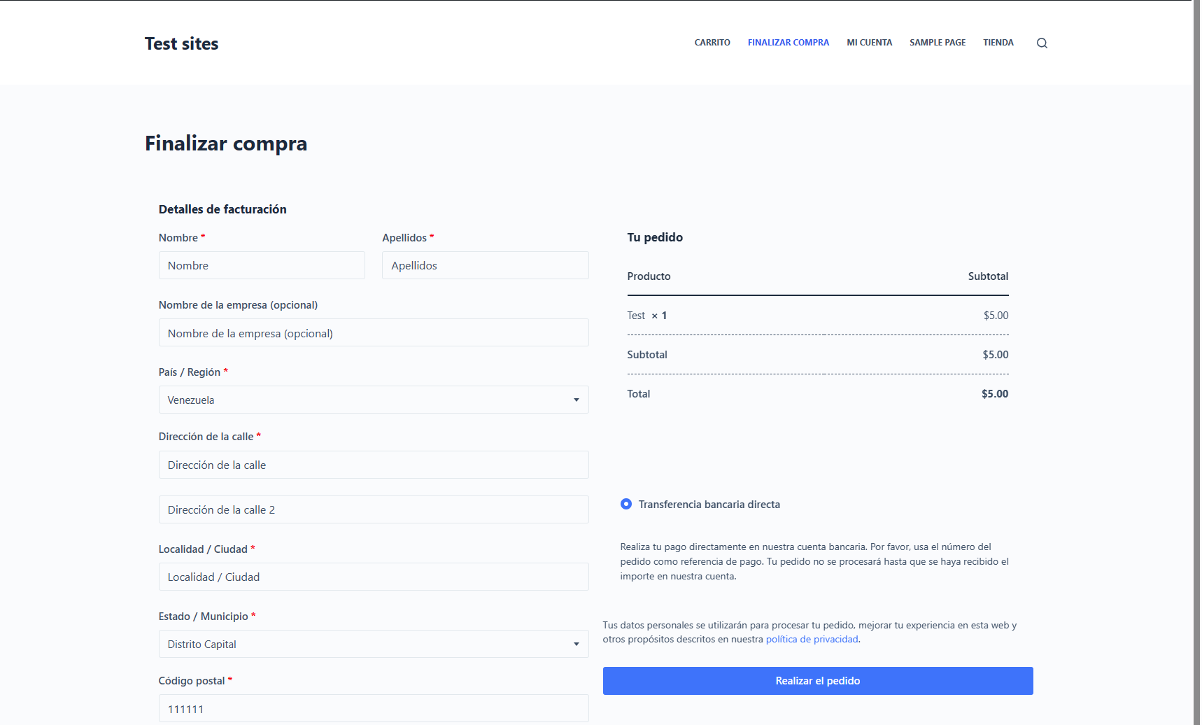

      I understand you, here is a detailed summary:
      I have a website with Elementor, Woocommerce and Jetwoobuilder from Crocoblock.
      It happens that when I change the Elementor sections for Flexbox, I have problems with the styles of the Jetwoobuilder widgets that customize the different Woocommerce pages, specifically the following pages: cart, checkout, thank you and those associated with my account.
      I contact Jetwoobuilder support and they tell me it’s due to issues with the theme’s styles. Since testing with the theme “Hello Elementor” these problems did not occur.
      What are the problems presented?
      • Change of color and style of lines of the tables.
      • Absence of lines in the tables and some sections.
      • Change the width of the subpages of my account.
      Reference images:

      Ok, I have taken a look and reported everything to the devs. The HTML/CSS structure is really wack to be honest, but I’ll see what they have to say about this.
      Be in touch!
      Hello @alfredo1216
      An update will be released shortly that fixes this. Though, this will be a two-part fix, as a bigger update is needed for more major changes.
      Until that other update will be out, you will need to use a little bit of CSS –
      :root {
      	--e-temp-border-color: var(--border-color);
      .e-con table,
      .e-con th,
      .e-con td,
      .e-con .woocommerce-customer-details address,
      .e-con .woocommerce-customer-details .woocommerce-column__title,
      .e-con ul.woocommerce-order-overview.order_details {
      	--border-color: var(--e-temp-border-color);
      This ensures that some variables aren’t overwritten.
      Be sure to stay up to date in order to always receive the latest fixes.
      Hope this helps!
      Thanks.

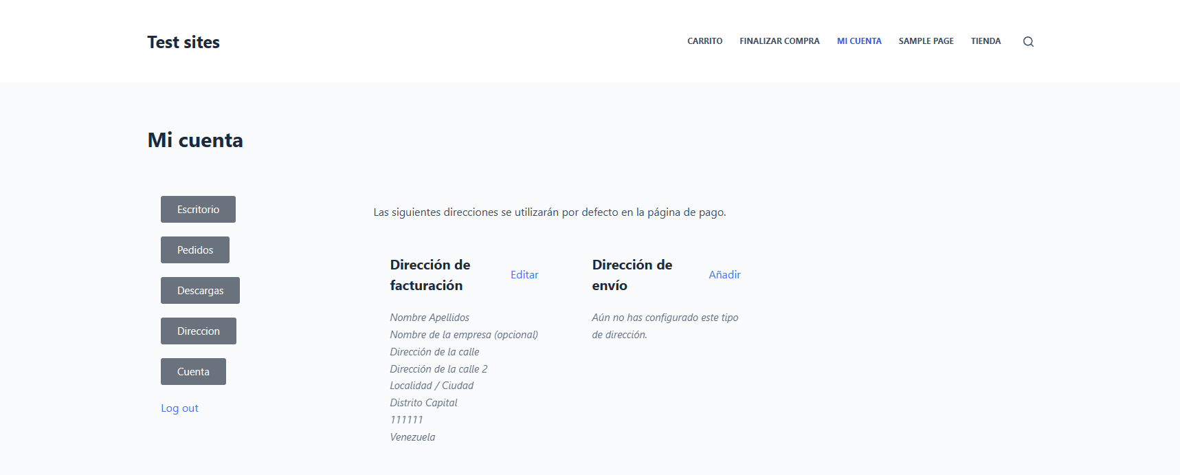

      Updated and with the CSS code integrated. Checking on the website most of the errors have been fixed, so far I have seen only one error that continues to show (Addresses section in my account). But I understand that it will be part of the more complete update that they have to carry out.
      Thank you very much for your excellent attention, and I will be attentive to that future update that corrects all the errors presented and does not need additional CSS.
      Greetings,
      Hi @alfredo1216
      Could you please let me know more about the “addresses” section? I think we’ve gone through the entire setup and everything should be OK now. Though, we’d like to hear more about this.
      Thread Starter alfredo1216
      (@alfredo1216)
      Yes, here I detail the information in the address section.
      In the previous version of the theme the section was displayed with this border style.
      In the last update this style disappeared.
      At the same time, I wanted to tell you that in the last update I am having a problem with the “P” tags since they contain a margin-botton that disproportions the content created in elementor since it cannot be modified.
      I will be attentive to your comments.
      Greetings,
      Hi @alfredo1216
      First off, I can say that the <p> tag issue will be fixed soon. It is due to an Elementor update which has changed a few things behind the scenes, but we’ll manage.
      Regarding the account error, I’m not entirely sure I follow. I still have the templates sent by you previously, but the issue seems to reproduce on all themes out there. Here’s how the page looks like with the default theme – https://ibb.co/vVJHsXc. Are you sure this isn’t a plugin problem? Maybe try to get in touch with Crockoblock for this one?
