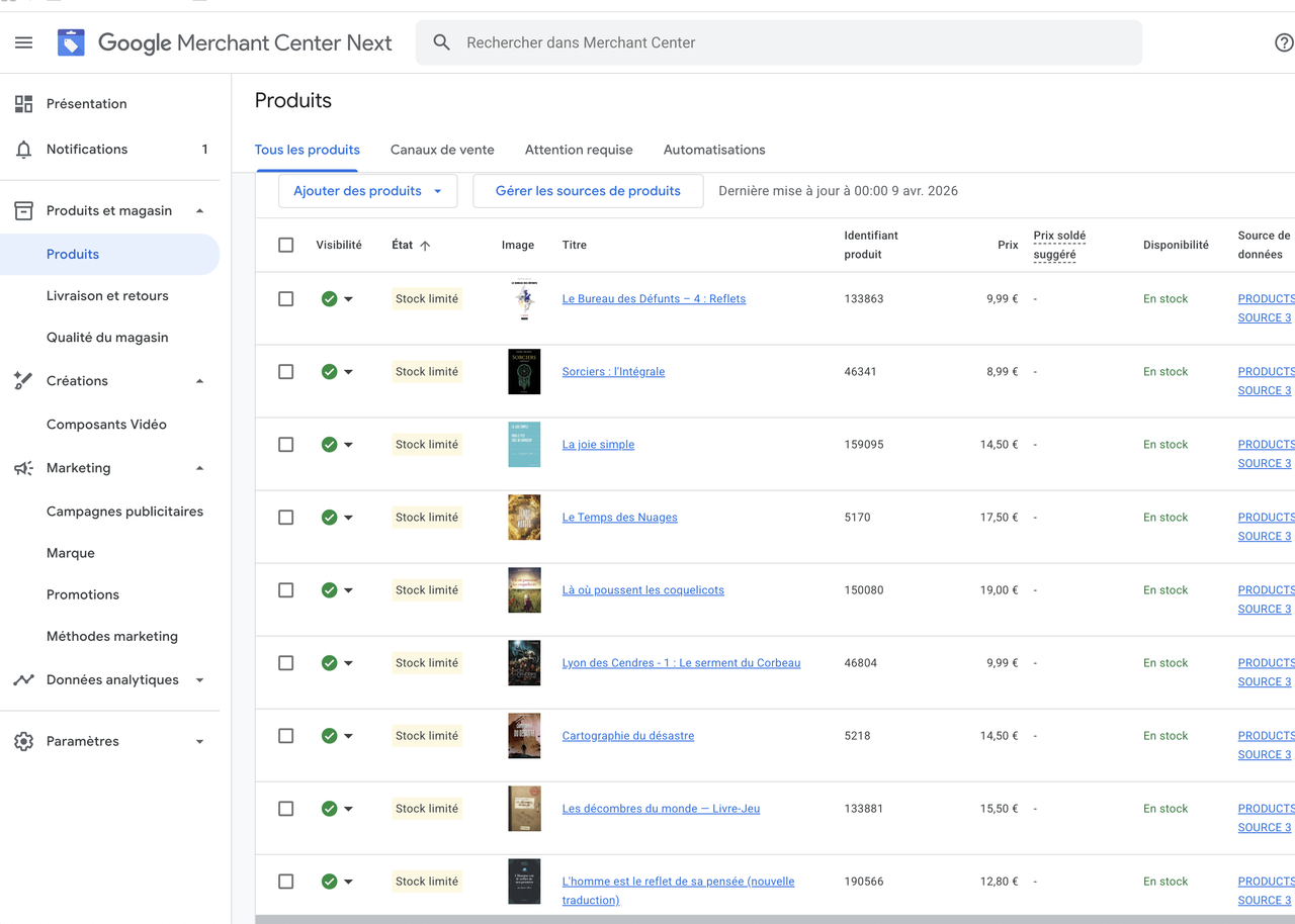

    On the store’s website itself, the stock status is clearly marked as “in stock,” so I don’t understand why Google is showing an error. However, on Google Merchant Center, as you can see in the attached screenshot , the products (books, in this case) are listed as “limited stock.” But the green checkmark seems to indicate that the titles are still online and visible—is that correct? So the feed wouldn’t be causing a blockage…?

    Thanks a lot for sharing the feed link and the screenshot, which really helps clarify things.
    First, regarding your concern:
    Yes, the green checkmark in Google Merchant Center means your products are still approved and visible, so this warning is not blocking your listings. That’s why they are still online.
    Now, about the “limited stock” / “inventory data missing” message, here’s what’s going on:
    About inventory data & quantityIf you have a physical store, then Google expects actual stock quantity through a separate feed called the Local Products Inventory Feed.
    This feed includes real stock numbers (quantity), which is not part of the standard product feed generated by Product Feed Manager.
    You can create this using our guide here: How to Create a Google Local Products Inventory Feed
    Once submitted alongside your main feed, this type of inventory warning usually goes away.
    If you are only selling online (no physical store)Then you do NOT need to send product quantity at all.
    Google only relies on: availability (in stock / out of stock)
    So your current setup with PFM is already correct.
    Why do you still see a “limited stock” warningIn e-commerce cases like yours, this warning usually comes from how Google interprets the data. The most common reasons are:
    1. Accidental Local Inventory activation: Sometimes this gets enabled unintentionally. Please check:
      – Google Merchant Center → Settings → Add-ons
      – Make sure: Local Inventory Ads and Free Local Listings are disabled
    1. Availability mismatch between feed and website: Google compares your feed with your product page. Example issue:
      – Feed: in stock
      – Website: unclear or shows limited/unavailable
      Fix:
      – Make sure your product page clearly shows “in stock.”
      – Enable Automatic Item Updates in: Tools & Settings → Automatic Improvements
    1. Missing attributes for certain availability types: If any product is set as:preorder  or backorder
      Then Google requires:availability_date
      Fix: Add this attribute to your feed (only if you use those statuses)
    Final noteFrom what you’ve shared so far, your feed is not blocking your products, and PFM is sending the required availability data correctly.
    This warning is coming from Google’s side, and it evaluates stock signals.
    Please go through these points in your Merchant Center settings and let me know what you find.
    Best Regards,
    – PFM Support Team

    Hello, thank you for this detailed response. You’re right—my site isn’t a physical store, but solely an online shop.
    So technically, I can leave the products listed on Google this way. They’re just marked as “limited stock,” but ultimately, that’s not a big deal since the products are still showing up on Google.
    Next, my second point: I went to Google Merchant Center > Settings > Add-ons, and I don’t see “Local Inventory Ads” or “Free Local Ads.” I don’t have those; I have “Free Product Listings” and “Promotions.” But maybe “Free Local Ads” = “Free Product Listings”?
    Finally, I have one last question: the feed I created with your plugin is set to update once a week. Can you confirm that, as a result, if—for example—during the week, I add a product to my store, validate it, and publish it online, will Google automatically update and pick up the new product I’ve added to my store, or is there something I need to do with the feed itself—like click “refresh” or something like that?
