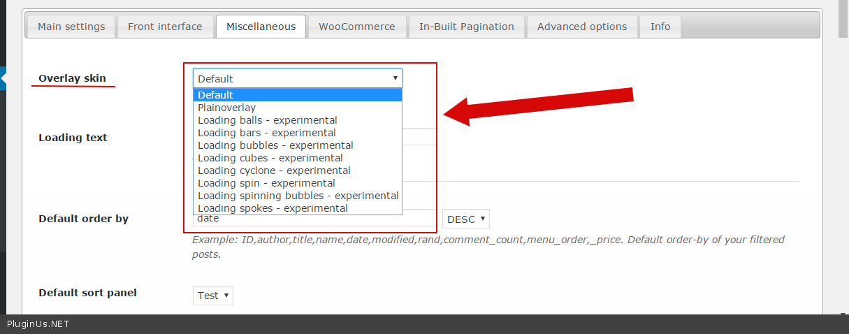

thanks for your help the animate=0 works – Is there a setting where we can get your loading gif instead of ONE MOMENT?

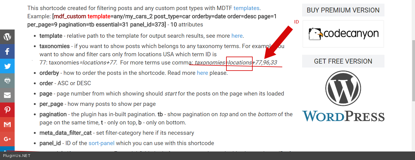

the problem with the exclusion still exists:
we are using project-categories and we want to exclude some but if we use this shortcode it is not working, we still get the all the categories included
[mdf_results_by_ajax shortcode=”mdf_custom template=any/flippingrocks_1 post_type=project orderby=date order=desc taxonomies=ausbildung,aushilfsjobs,studium,fachkraefte,praktika,studierende” animate=0]

Hello
your loading gif instead of ONE MOMENT? – http://c2n.me/3Htjf98.png
You use the incorrect syntax
Please read this( http://c2n.me/3HtjH3E.png ) – http://wp-filter.com/features/shortcode-mdf_custom/
