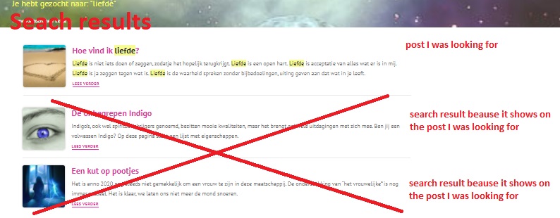

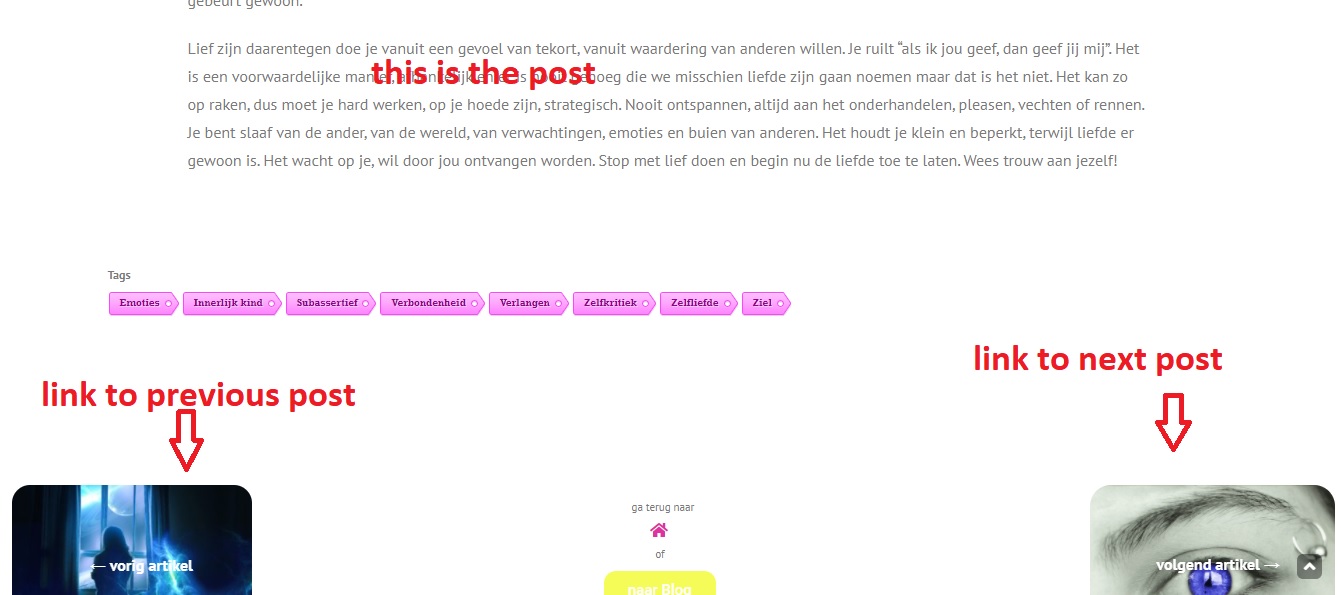

    Hi, is it possible to exclude certain page content from search with this plugin?
    I have a banner on a page that links to another page. When I search for the page the banner is on, the default WP search show both the page and the pge the banner links to.

    Thread Starter noratom
    (@noratom)
    Plugin Author Mikko Saari
