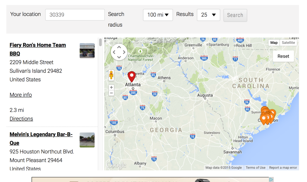

    3) If I allow the map to find my current location, why does it not go ahead and find the locations in my area? I would expect that to be the default behavior. It is not intuitive to say OK and then to have to click search to find the locations in my area. My experience in Atlanta was that I clicked OK to find my location and, on loading, the map showed markers in my hometown area of Charleston, SC. (See this screenshot) Only when I clicked Search did the locations near me show.

    As for #3, I would tell you that I thought it worked as one would expect, but the screenshot you see was basically the same result I got on the iPhone on the cellular network. So both the laptop and the phone — on two different networks — yielded the same result. Note: I was using Safari in both cases, however. I did not try a different browser on either.
