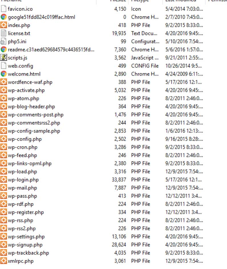

    http://chapiescomics.com/ryzom/Dee1.jpg
    No such files in the main folder…

    check in the file called php5.ini.
    Where are your WordPress folders? Did you crop them out of the picture or do you have them in a different location?

    I deleted the php5.ini file because all it had was this in it:
    ; Wordfence WAF
    auto_prepend_file = ‘D:\Hosting30504\html/wordfence-waf.php’
    ; END Wordfence WAF
    and now it seems as though my site is back up.
