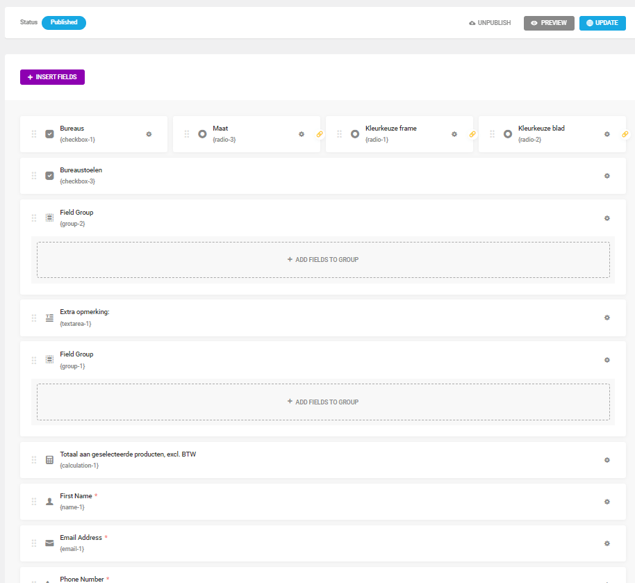

    I am experimenting with an order form and see some problems using the Field Group feature.
    • For each Field Group I use, below the field groups an empty group becomes visible.
    • Field groups are added to the top of the form when you display them in your site (but not in the form config page). Any other field you place above or between the group fields get displayed below the group field in the end result.
    • You can set the border radius and thickness, but it does not show in the end result. (the border in the picture is a form border, not a field group border).

    Hi @wp_con
    I tested your form and all seems to work fine. The issue here is that you have your group fields empty and no fields added inside. The background, border you see is a default design for the group field box. In short, all the fields you have in this form are not inside those group fields.

    Thread Starter WP_Con
    (@wp_con)
    That is VERY strange… And I discovered why (and it’s worse than I thought πŸ˜‰
    I placed the items in the corresponding field groups like this:
    The result when I load the form is this:
    (yes I pressed “update”! )
    But when I go back the the form settings, and press F5 to reload, I get this:
    The fields are taken out of the group again…
    So the problem is maybe even more serious than I thought πŸ˜‰
    I made this screenrecording to prove this:
    https://kantoorenomgeving.nl/files/EditFormReload.mp4
    Any Ideas?
