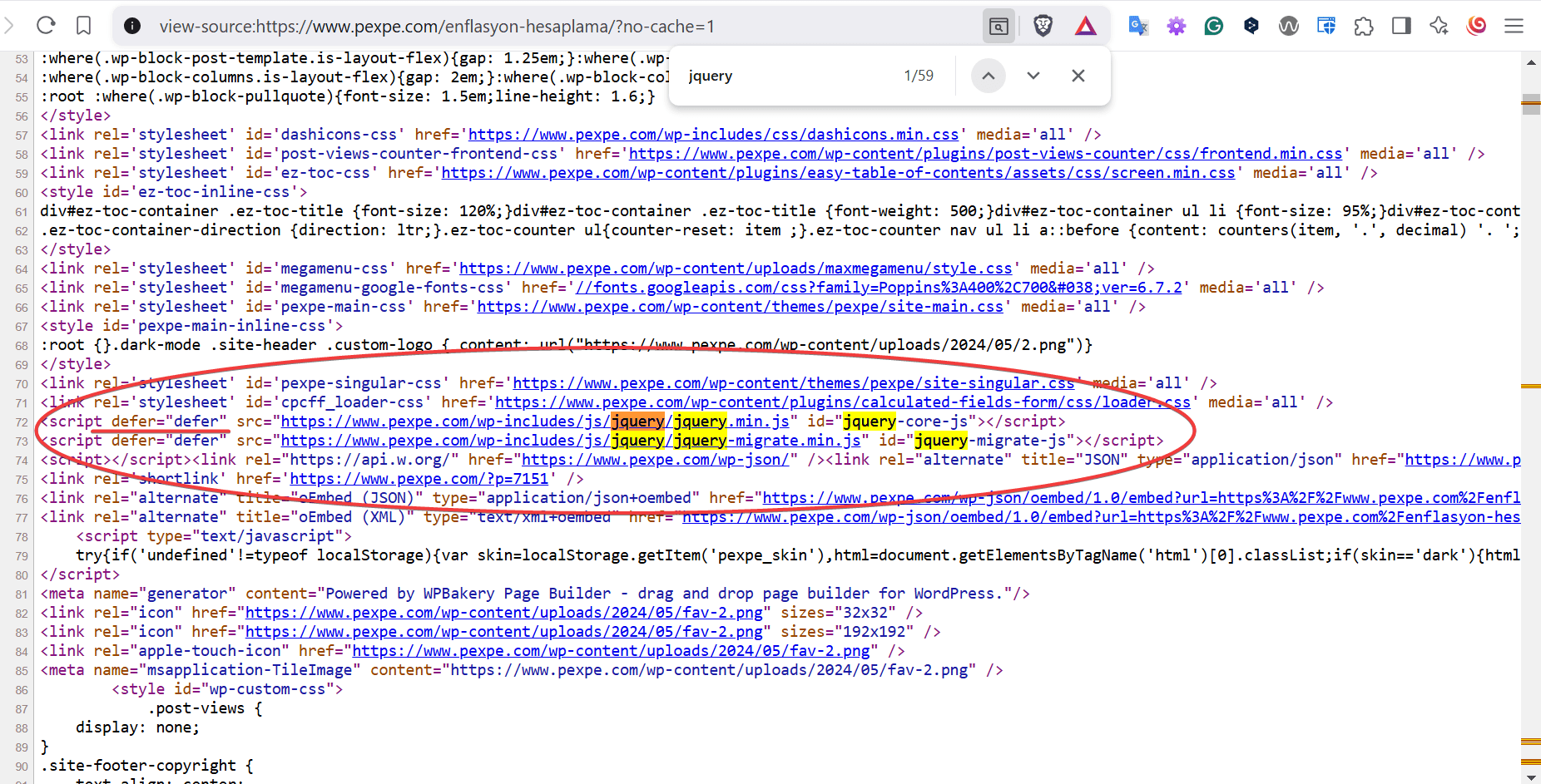

    I recommended not delaying or deferring the jQuery library, but if you check the page source, you are deferring its files:
    Thread Starter pexel
    (@pexel)
    I have removed the defer attribute from the two files as you suggested. I will follow up and keep you updated on the progress. Thank you!
