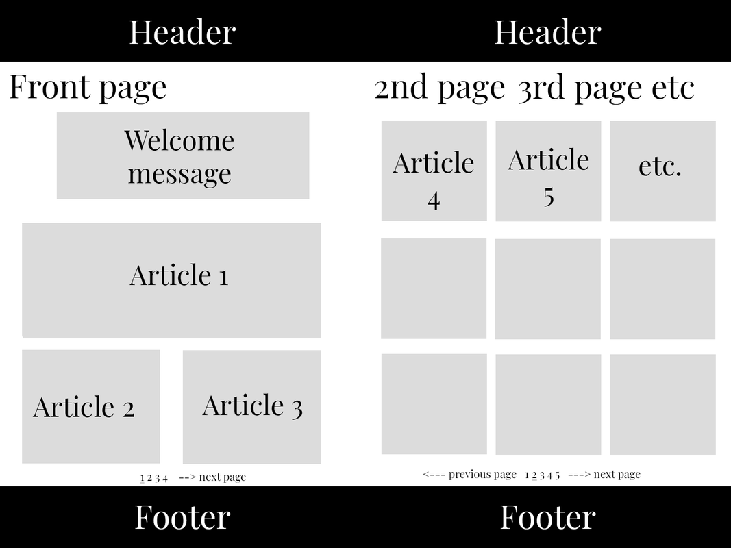

    Hello!
    I would like to know if it is possible to create a front page where I can show a welcome message and some blog posts, then when you click on the next page link you get only posts? Something like this: https://postimg.cc/23kx9vHM (I don’t want a separated blog page 😄</img>)
    I tried to create a static page but when I insert the query loop block, the template for the next pages is the same as the front page 🧐</img>
    Thank you for your help!! 🙂

    Hi @adeuh – I don’t think there’s an easy way to modify the functionality of the core Pagination block, but here’s how I achieved this on my test site. There are quite a few steps, so I suggest going slowly through them one at a time. If you run into any issues along the way, just let me know!
    • Under Appearance > Editor > Templates > Home, modify the homepage template as follows:
    • Add a Cover block or other block for your Welcome text at the top of the page, under the Header template part.
    • Inside the existing default Query Loop block, remove the Pagination block. Set this first Query Loop block to display only 1 post. If you don’t see the setting on the block toolbar to select a number of posts to display in the loop, be sure “Inherit query from template” is toggled off in the block settings in the right-hand panel.
    • Below the first Query Loop block, add a second Query Loop block, also with no Pagination block.
    • Set this Query Loop block to display two posts, offset by 1, and select the grid format. Here’s a screenshot showing the settings on the second Query Loop block:
    Editor beta A Magnificent Test Site WordPress
    • Set all these blocks to use whatever alignment you prefer. On my test site, I thought the Cover block looked good set to full width, and the two Query Loop blocks below it set to wide width, but you can experiment with the settings to see what you like best.
    • The last thing for your Home template is to add a link to your new page that will display the rest of your posts. On my test site, I added a right-aligned Paragraph block that says “More Posts” but you can use whatever wording you prefer. We’ll come back later and add a link to this text.
    • Here’s what the complete block structure of the modified Home template now looks like:
    The second part of this process is creating a static page for the rest of your posts:
    • Under Pages > Add new, create a new page called More Posts (or your preferred name).
    • In the page editor of your newly created page, add a Query Loop block. Select the grid format, and offset it by 3 to skip the three posts already displayed on the homepage. (You’ll want to keep the Pagination block this time.)
    • Publish your new page.
    The third and final part in this process is to return to Appearance > Editor > Home, to add a link from the words “More Posts” (below the second Query Loop block) to your newly created More Posts page.
    Voilà! On my test site, everything now looks like your screenshot.
    I know there are a lot of steps here, and hopefully I haven’t inadvertently left anything out, but this is a no-code way to achieve your goal. Let me know how it goes!

    Thanks for your answer, I have done your recommendations and it works!! 🥳 Thank you so much!! 😃</img>😃</img> However, I encounter a small problem: the pagination automatically adds an additional page without articles. Do you have an idea to solve this?
