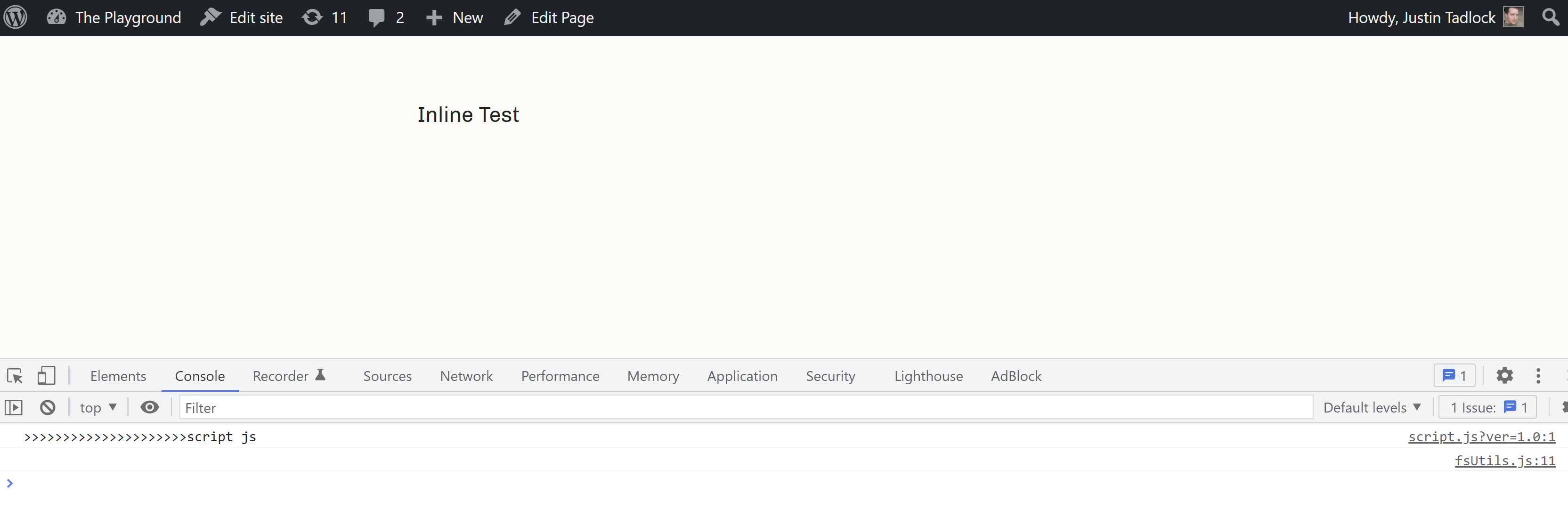

  • I tested the POC plugin with the Archeo (block) theme and the latest WP 6.0 dev branch, and it is working: https://cldup.com/54uNwN9T7X.jpg
    Are you running against 5.9? I’ll do some digging to see if there was an issue that has since been corrected.

    Just FYI it doesn’t work for me on Archeo
    Only the script file not the inline

    Ah, I see what I missed earlier too. I thought the console.log() call was just for the inline script and not both. No, it’s not working for me either.
