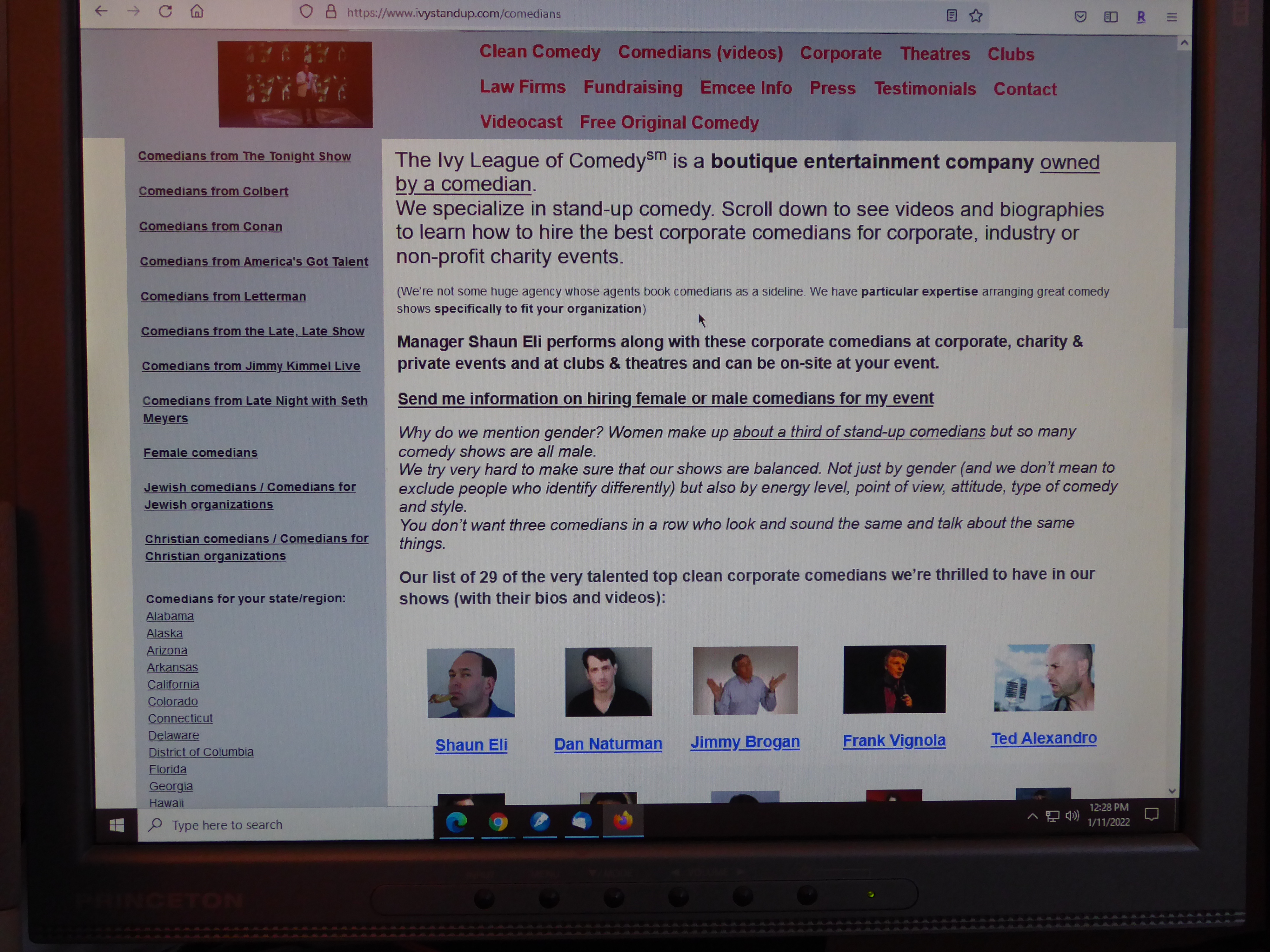

    Thread Starter shaunshaun
    (@shaunshaun)
    No screenshot but here’s a photo of the screen:
    https://brainchampagne.com/resources/sidebar.jpg
    Here’s my css, in case you can look to see what the conflict might be, if it matters:
    @media (min-width: 992px) { .page-id-60 .main.col-lg-9.col-md-8 { float: right; } }

    hannah
    (@hannahritner)
    Oh I see. You’e using a smaller screen so that space is mall. I’m seeing it large, as the container stretches on either side. Are you wanting the content to be fullwidth? If so, you can use this css:
    .container div#content {
        width: 100%;
    In your current css, it looks like you have an extra bracket in your first css snippet. Here:
    Remove the second closing bracket. Then in your last two css snippets you actually need closing brackets. Here:
    (@shaunshaun)
    You rock!
    FYI the photo was a normal-sized and width 17″ monitor. On my widescreen monitor it also had the white space to the sides. Your css fixed it. Thanks!
    So I get it- the {} are like <> in html- for every one that opens a code you need one to close it.
