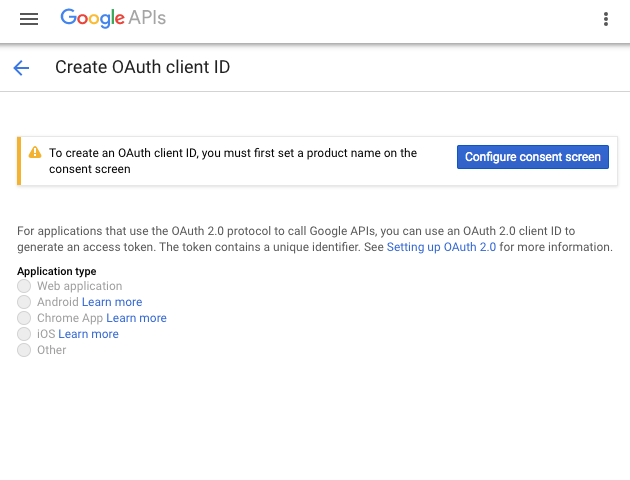

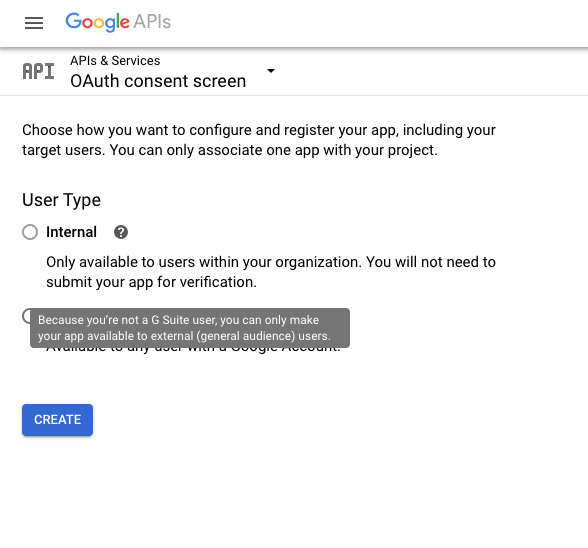

    After creating a project, when I click “Create OAuth client ID” I am presented with options including “Web Application”. However, all options are greyed out and I am told I must first “Configure Consent Screen.”

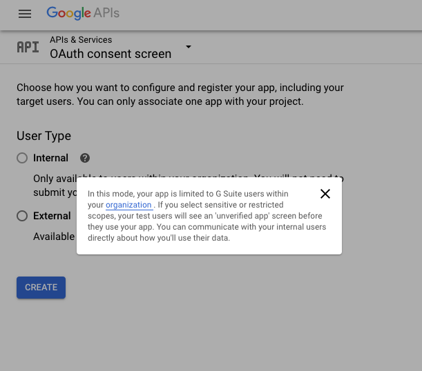

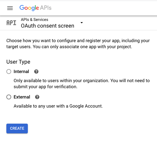

    When I click that button, I see two options:
    Internal – Available to internal users only, no application.
    External – Available to any google user, application required.

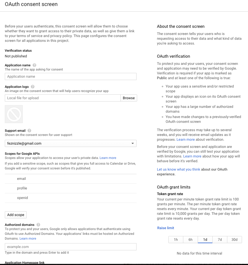

    Because I do not have G Suite account ($6/month), I can only choose “External”. When I select it, I get a big form to fill out and have no idea how to fill it out.

    Can you provide me with a screenshot of the form, please?
    As it has happened so often in the past, Google seems to have changed things again! But, if you are seeing the same form as I do, the only thing you really need to fill out is the “Application Name”. Put in anything you want there, like “Photonic Test”, and Save. You should now be able to go back to “Credentials” and add a web application.

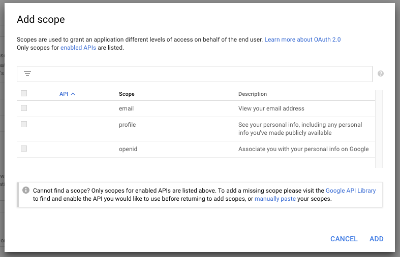

    Sorry for the delayed response. Ok, I went back and there was one aspect that gave me pause:Adding “Scope” to my application.
    Here are the relevant screenshots:
    https://mitty-walters.com/image_share/photonic/01.png
    https://mitty-walters.com/image_share/photonic/02.png
    https://mitty-walters.com/image_share/photonic/03.png
    https://mitty-walters.com/image_share/photonic/04.png
    https://mitty-walters.com/image_share/photonic/05.png
    https://mitty-walters.com/image_share/photonic/06.png
    https://mitty-walters.com/image_share/photonic/07.png
    https://mitty-walters.com/image_share/photonic/08.png

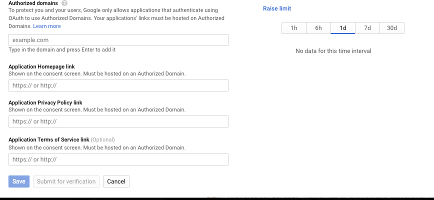

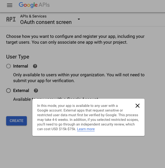

    I also don’t know what to do about the “Privacy Policy” link and the “Terms of Service” link. Additionally, if you read the info in 04.png you will see that this process takes 4 to 6 weeks!!!
    Curious what you make of all this.

    In screen 6, just put in the Application name, as I specified in my post above. That should let you save, and you should be able to create the Client ID.
    After that you can directly jump to the workaround process.

    You were correct! It did allow me to save and continue after simply putting in a name!

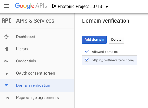

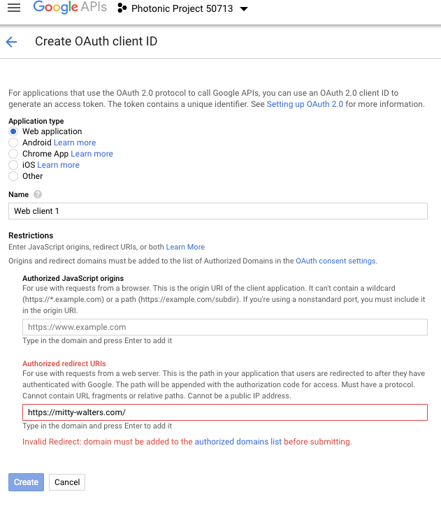

    But now I am stuck again, with what seems mindblowingly simple: adding domain as authorized.
    Looks like I did that, but it still won’t let me use it:
    https://mitty-walters.com/image_share/photonic/09.png
    https://mitty-walters.com/image_share/photonic/10.png
    Thread Starter Feznizzle
    (@feznizzle)
    Hold the press!!!
    I went back to my “Consent Application” and added the domain there, seems to be working now. Will follow up shortly.
    BTW, I aslo went thru the domain verification process through console.

    Two things to note for your updated instructions. First is that you have to give the consent application a name *and* you have to provide the “Authorized Domain”.
    It is likely that the user will also have to go through the domain control verification process via Console, then add it as an authorized domain. I did all that prior to realizing I need to add an “Authorized Domain” to the consent application above.
    When adding a property (domain) to console, there are two possible routes. I would advise that you tell users to verify via uploading a file to the domain. I initially tried to verify by adding code to DNS txt file, which was a pain… only to be denied over and over while waiting for it to update. Impatient, I tried the second route and was verified instantly.
