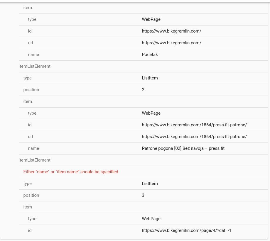

    “Either “name” or “item.name” should be specified”
    This error means that the breadcrumb markup does not have a title. This could mean that either the page itself doesn’t have a defined title (appears as (no title) in the page overview) or has an empty breadcrumb title. To check the breadcrumb title, please follow the steps here.

    Google released a Breadcrumb Report as part of the Search Console. See https://twitter.com/googlewmc/status/1174693878835875840.
    Somehow, Google crawled your site and found these kinds of URLs like https://www.bikegremlin.com/page/4/?cat=-1. We are not sure how they did that.
    Upon looking at the source code we on those kinds of pages it lacks the “name” , “ID” and “URL” schema for the last breadcrumb listitem. See image: https://pasteboard.co/IyTUvsT6.png. We are not sure why Yoast is failing to output it.
    We are also not sure if these errors are important to resolve as the canonical of the page points somewhere else. See: https://pasteboard.co/IyTV97J.png.
    Clicking on it: https://www.bikegremlin.com/1864/press-fit-patrone/page/4/ redirects you to https://www.bikegremlin.com/1864/press-fit-patrone/. So that post is what Google is expected to crawl and index as Google is expected to follow the canonical tag. Indeed, we can see Yoast is outputting the breadcrumbs for the last items on that post correctly. See image: https://pasteboard.co/IyTVXeo.png.
    We need your help as we are not sure why Yoast is at a minimum not outputting the breadcrumbs on https://www.bikegremlin.com/page/4/?cat=-1 as in our testing Yoast outputs the right breadcrumbs on that kind of page.
    If you were to perform a conflict check as described here https://kb.yoast.com/kb/how-to-check-for-plugin-conflicts/ and have a standard theme and only Yoast SEO active and then check the source code on https://www.bikegremlin.com/page/4/?cat=-1 and look for that last listItem does it show name, ID, and URL? This guide explains more about how to check the source code: https://kb.yoast.com/kb/view-page-source-site/

    It seems that somehow Google discovered a URL format that is only used when your site doesn’t have permalinks defined. The plain permalink option used variables (like ?cat=-1) to determine the content to display.
    Doing a little research the ?cat=-1 tells the post/page to show all content except what belongs to category if of 1 (which is likely the default category).
    I also noticed that the canonical of that page doesn’t match the URL
    URL: /page/4/?cat=-1
    Canonical: /1864/press-fit-patrone/page/4/
    URL: /page/5/?cat=-1
    Canonical: /1057/podesavanje-drumskog-kormana/page/5/
    I cannot reproduce this in a default install and the test install you provided is marked noindex so the canonical doesn’t output. And the test install doesn’t appear to have breadcrumbs enabled since I don’t see them in the source code for a post (the easiest place to spot them). If you enable breadcrumbs on the test install you provided, is the breadcrumb markup valid on an equivalent page of https://test.bikegremlin.com/page/2/?cat=-1?
