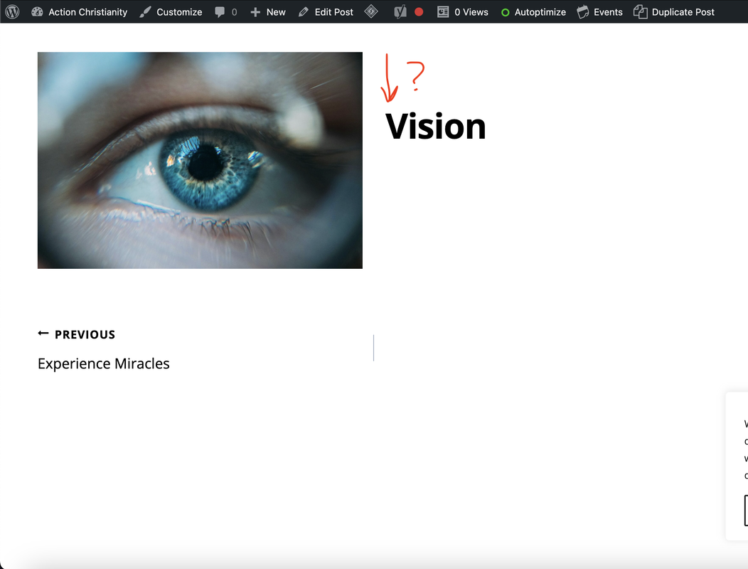

    Also, I just noticed that disabling your plugin also resolved another issue which appeared recently in which Kadence’s Text (Adv) blocks are no longer vertically aligning properly on WordPress posts (for some reason it happens only on WordPress posts and not on pages). When I disable your plugin the problem goes away.
    https://i.postimg.cc/Qdq0Tn0B/Outlook-wn0z2ndj.png
    https://i.postimg.cc/kgwv4RgK/Outlook-0bqxjbh2.png

    That is interesting, I will create one of those blocks and see if I can figure out what the cause is.
