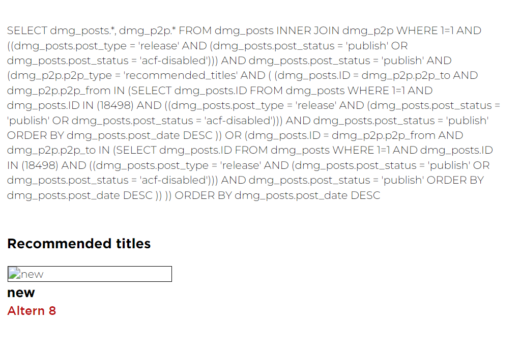

    Thread Starter ashimasukhija1
    (@ashimasukhija1)
    https://i.ibb.co/4SvbrsT/wp-p2p.png
    The above screenshot is from single.php page where the posts-to-posts plugin creates bidirectional relationship between different custom posts which is created by the ACF plugin.
    https://i.ibb.co/bdbstvb/wp-p2p1.png, code screenshot is also attached.
