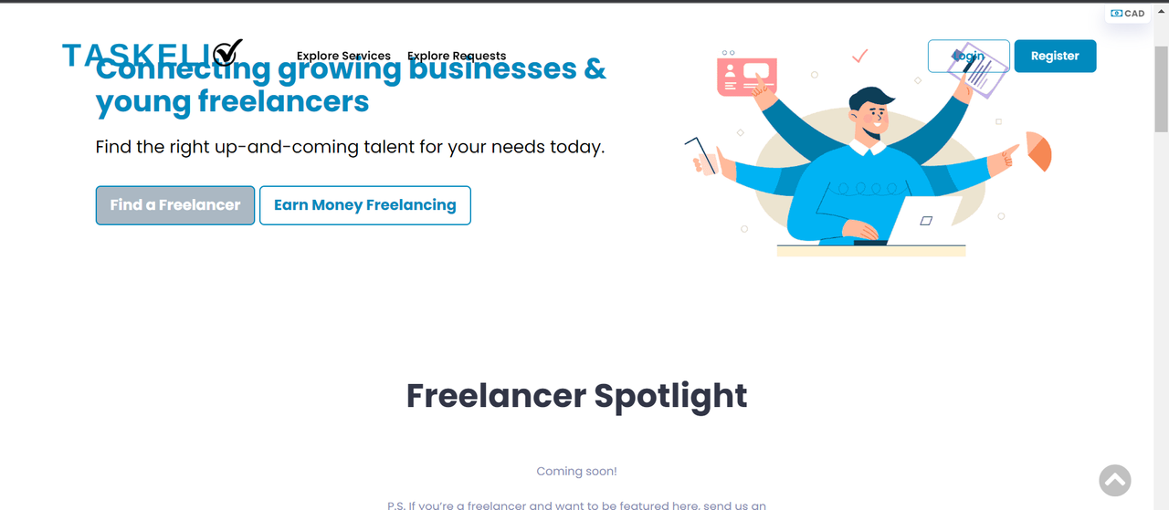

    So I’m trying to optimize my site, but with both CSS and JS minification on, it makes my website header turn from a white background to a see through one sometimes (see pic at end). Additionally, on mobile, it sometimes causes the buttons to become unresponsive on the header and footer.

    Header issues: https://i.postimg.cc/QdJSmzwr/Screenshot-2022-10-31-214015.png
