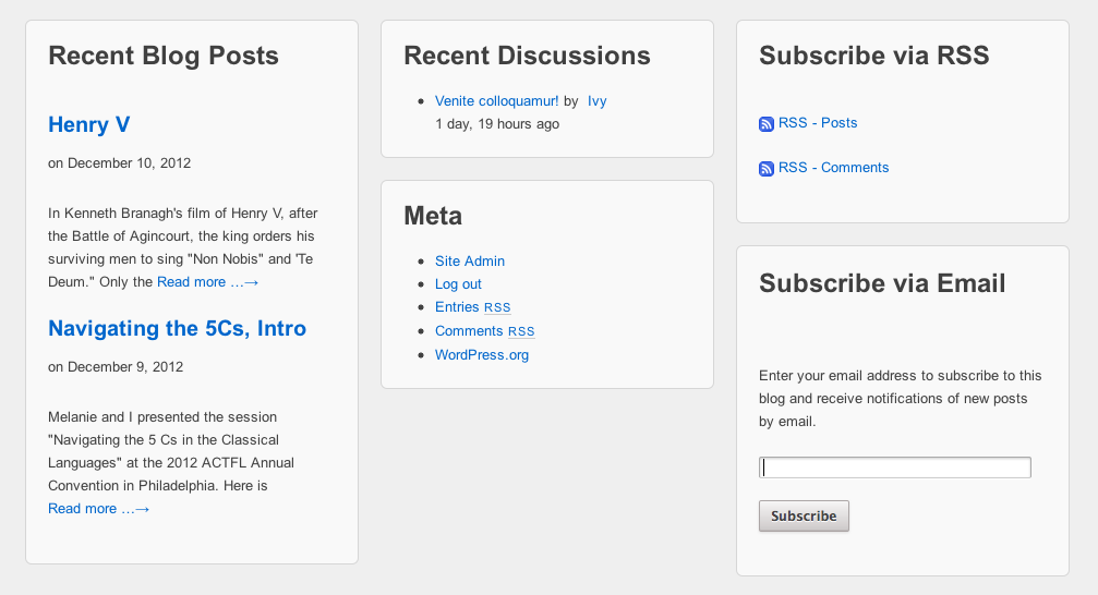

    I’m having a problem with uneven padding in the home widgets. This image shows that there is a different amount of space under the widget title in each of the home widgets.
    http://www.forummagistrorum.com/wpb/wp-content/uploads/2012/12/HomeWidgetIssue.png
    I found some posts on spacing issues and tried adjusting this css so that the padding was 0 all around.

    While this made the “Recent Posts” and “RSS” widgets look OK (some space remained between the title and content), the “Recent Discussion” and “Meta” ones ended up with no space between the title and content. Since “Recent Discussion” and “Meta” are both ul, should I add padding before a ul in a widget somehow?
    And the “E-mail” one still had a huge space that looked the same. Can anything be done about that?

  • Please see this post for Jetpack subscription. Recent post (plugin) I would say is embedding their own styles and that’s virtually impossible to override:
    <h3 style="clear:none;"><a style="text-decoration:none;" href="http://www.forummagistrorum.com/wpb/2012/12/henry-v/">Henry V</a></h3>
    and
    <div style="padding:5px 0;"><span style="text-align:right;">on December 10, 2012</span></div>
    Please try another plugin that doesn’t do this πŸ™‚

    You were absolutely right about about the Featured Category plugin used for Recent Posts applying its own CSS. I tried another plug-in and it doesn’t do that. Thanks!
    As for Jetpack, I added the 3 blocks of CSS at the link you mentioned and that didn’t solve the problem. What did make a slight difference was adding
    .jetpack_subscription_widget h3 {
        padding-bottom: 0;
    The Jetpack gaps were still pretty large, but both gaps seemed to be the same size with that. Is there anything else I should try?
