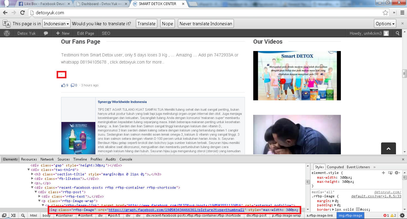

    I think this plugin get some mistake, image not showed of post facebook it’s just get litle border.
    Check this source for image maybe wrong.
    It should be JSON_DECODE from https://graph.facebook.com/{$item_id}/picture?summary=1&{$this->authToken}&redirect=false . That source from IK Social, I hope you fix that problem.

    Actually, the way I did it in my plugin should work as well. Do you have a live URL to the website you’re showing in your screenshot so I can take a closer look?
    Thread Starter ginc0der
    (@ginc0der)
    Wow … the picture just appeared. maybe it’s all because the extension of the browser.I just remove extension Avast 9.0 from the browser.
    This problem is solved now danny. Thank’s.
