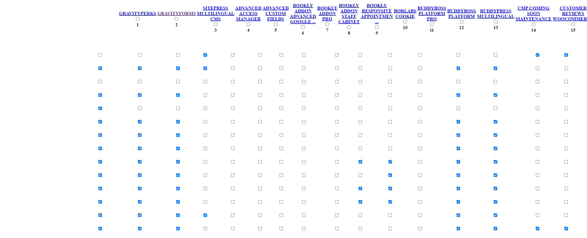

    1 – First one : Incompatibility with the plugin UI Press
    Whole page is totally bugged, can’t even play to do something. Screenshot here : https://i.postimg.cc/Fr6cZygP/chrome-f-KP3-Eeq8-Ye.png
    My idea was to put a back-end url : */wp-admin/admin.php?page=eos* and disable this plugin but I can’t do that before activating the plugin, and after, I can’t.
    I will check if there is a way in database after that.

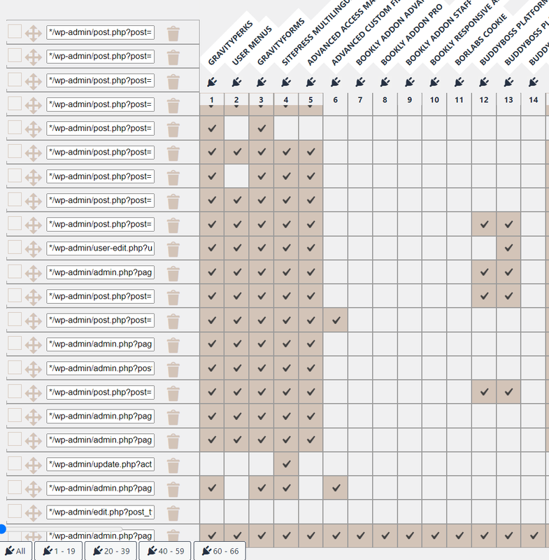

    2 – Having a label field for URLS
    See the screenshot : https://i.postimg.cc/504PSw-B9/chrome-6m-T9k-Ydp01.png
    Well, should be enough to understand my little pain here.
    I’m better at destroying things with php then adding so I didn’t try myself to use a hook to create my own label field but I think it could be useful to have this not only for me.

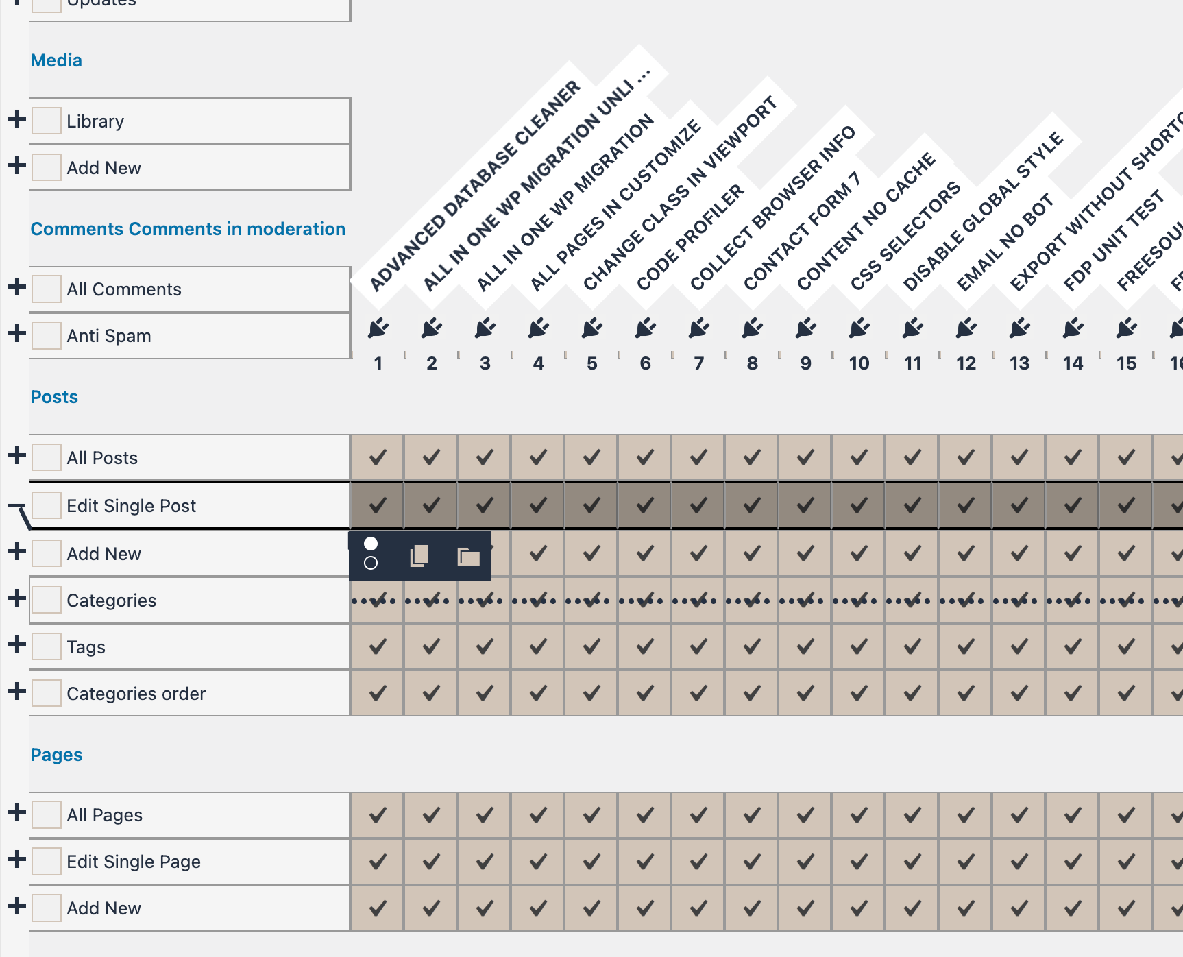

    2) THis is a good idea, thank you for the suggestion.
    However, I suspect that you are disabling plugins in the backend on the single post editing pages, aren’t you? If so, it would be better for you to use the settings that you find in Freesoul Deactivate Plugins => Baakend => Backend => Singles => Edit Single Post (or Edit Single Page, Edit Single …).
    See the screenshot https://freesoul-deactivate-plugins.com/wp-content/uploads/2022/05/freesoul-deactivate-plugins-backend-single-post.png
    In any case, the idea of custom labels is something that I will take into account for future versions.

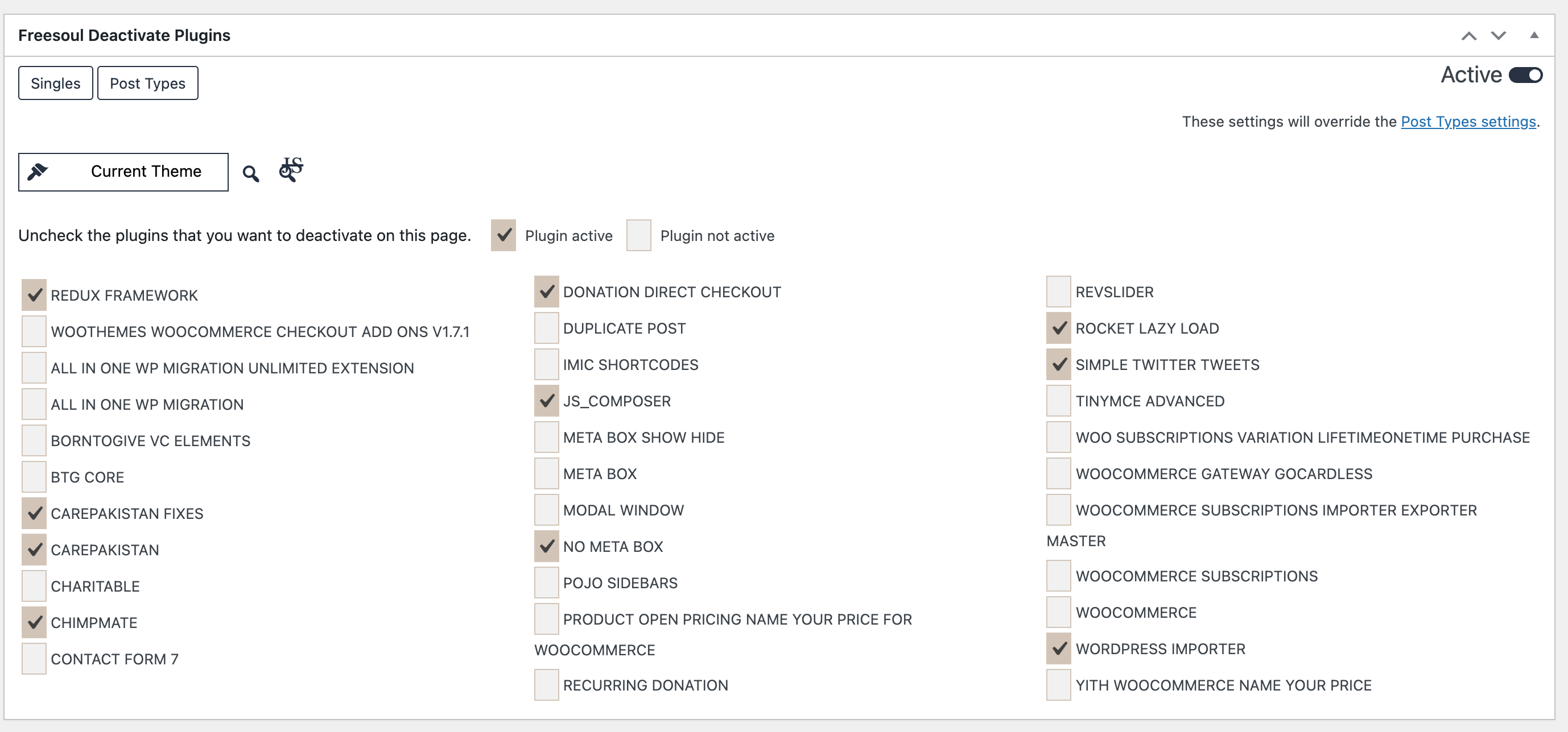

    3) I’m not sure I’ve understood what you mean.
    I understand this: on some single custom posts you can see the FDP section like in the screenshot https://freesoul-deactivate-plugins.com/wp-content/uploads/2022/05/deactivate-plugins-single-post.png, and on other single custom posts you don’t see it.
    FDP can disable plugins only if the custom post type is registered as publicly queriable.
    I think it would be easier if you give the example of a concrete case where you cannot disable plugins.

    1) Which free version ? I can’t find a free version of that plugin : https://uipress.co/
    I did try on a neutral dev environment to be sure it’s not related to settings and I can confirm it is not.
    I’m not having the issue on the “main page” of the plugin but with all others. Like eos_dp_by_post_type or eos_dp_url or eos_dp_by_term_archive&eos_dp_tax=category
    Here is a look : https://i.postimg.cc/rF8bGR7v/0.png
    With styles filter : https://i.postimg.cc/rwHPLnzk/1.png
    With styles + scripts filter : https://i.postimg.cc/TwV7gT0d/2.png
    Seems well better with both !
    If I disable the plugin from wp-config, it is working 100% as intended and got no issue like this.
    So my 2) is well related to my 3) and I got a fix, if I can say so.
    Demo of the situation :
    https://i.postimg.cc/Jn0gwf5M/Demo-1.png
    I want to disable all plugins except the LearnDash plugin when I’m editing Questions.
    I disable them, then I save.
    If I reload the page, it is back to everything is active.
    And if I check by myself, it is not working.
    And now I got the “why”, if I go far below, I can find another line about Questions.
    https://postimg.cc/7bj76TpK
    And this time, it is working as intended.
    And last and, when I make my choices below, it is then synced with the lines above that are not working.
    So I will delete 10 lines in my back-end url, that will help !
