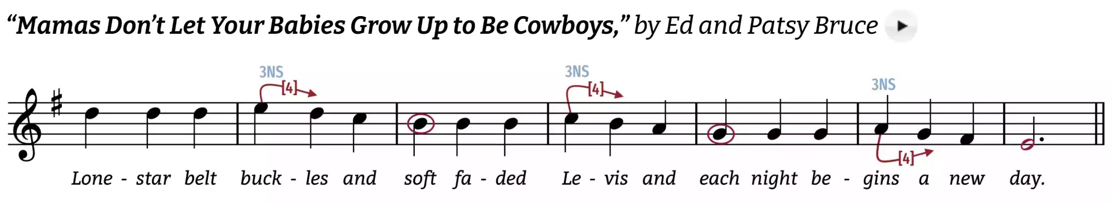

    I cut and paste into Gutenberg (6.1.1), using the “paste as plain text” option. Typically, the result looks like this.
    (The example above is a screenshot. Don’t expect the player to work.)

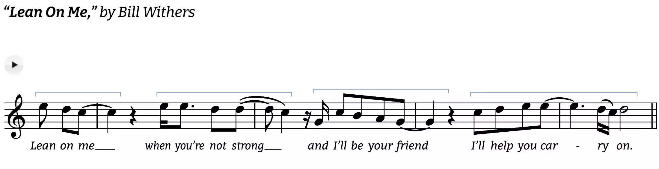

    It’s been several months since I wrote a new post. Today, when I tried my usual process, some of the examples (title, player, image) appeared correctly. But other examples—which are formatted EXACTLY THE SAME WAY—put the player on a separate line, like this:
    Several odd things at work here. I’ve spent all day trying to figure out why some examples format correctly and others do not. I hope someone has the key to free me from my agony!

    I put two versions of the “Lean On Me” example in this blog with the same code. To test that they were indeed the same, I copied that code from the WP editor and re-pasted it into Word with the paragraph and space marks visible. Here’s a screen shot:
    As you’ll see from the actual blog post, the two examples display differently.

    Word paragraph marks are not the same as HTML paragraph tags. When you paste in text with Word paragraph marks, it’s ambiguous how the editor would deal with them. It depends on the editor being used.
    What is different between the two examples is in the undesired examples, the title/artist text is wrapped with HTML paragraph tags and the desired examples are not. I’m unclear how you achieved either example, other than that it came from Word. It looks like you are using the Elementor editor, which I’m unfamiliar with. Consider asking for help in their dedicated support forum, where its devs and expert users are in a better position to help you.
