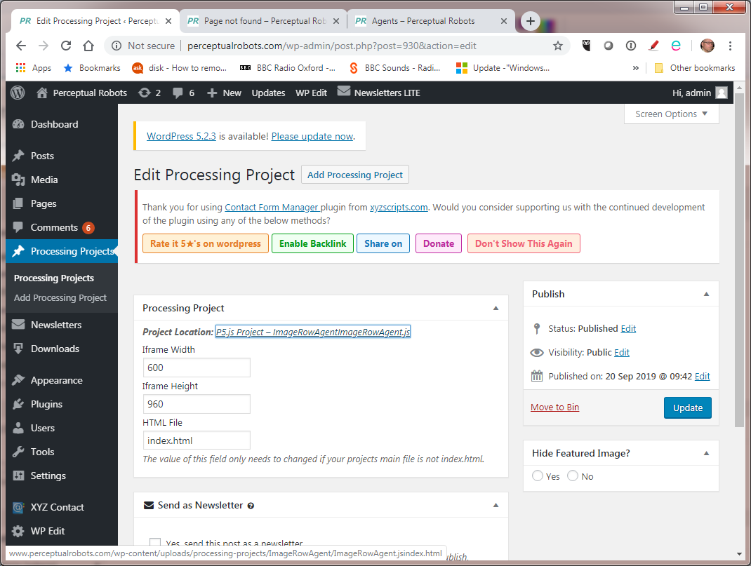

    Here is screenshot just after upload.
    screenshot
    You can see the link at the bottom when I hover over project location, which gives the filename as “ImageRowAgent.jsindex.html” rather than “index.html”.

    Great thanks. I can confirm that you have found a bug. It is something to do with the fact that your JS file has the same name as the folder/zip file.
    I found that if you change the name of the JS file (to script.js for exmaple) that it worked, here is an example zip that worked for me:
    ImageRow.zip
    I will do some further investigation after the weekend to see if I can find an easy fix for the issue.
