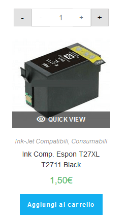

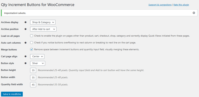

    If i change the position of increment button it’s not change and the “+” and “-” button is replicate. I use the OceanWP theme. If it’s possibile i can upload the screenshot of settings and display.

    OceanWP adds the buttons with JavaScript what is not optimal from performance and compatibility point of view.
    At the moment I am not able to dequeue OceanWP’s script responsible for quantity buttons through my plugin. It doesn’t seem to be properly enqueued BUT theme authors provided an option to solve it on their own side through Ocean Extra plugin which adds “Theme Panel” on your left-hand dashboard menu.
    Install and activate Ocean Extra, go to: Theme Panel > Scripts & Styles
    Disable “WooCommerce Quantity Buttons” and save the settings.
    I will contact with plugin support and try to get a clean way to suppress OceanWP quantity buttons out of the box in the future.

    I resolve the double increment button but the position of the button not is as i setup it. I selected after add to cart but it’s always on the product like in photo.

    I think that the best visual effect, in this case, would be with the quantity buttons above the Add to cart button.
    Based on already asked question from OceanWP support forum, there is at least a hook to put the buttons after Add to cart button, but I assume that in such a case also before hook will be valid.
