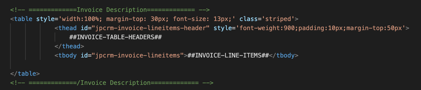

    We made some (small) changes to the invoice PDF generation functions (adding some class names, and removing the forced double border) in 6.5
    There’s a new template in invoice settings from 6.5 called “modern” which is a better starting point in my opinion.
    How does the “modern” template look for you if you choose that one? Here’s how it looks on one I just made.
    Although, when uploading this – I notice the “QUANTITY” “PRICE” and “AMOUNT” should be right aligned and will get this sorted in the next release.
    The part of the code which looks at the headers is here:
    https://github.com/Automattic/jetpack/blob/trunk/projects/plugins/crm/includes/ZeroBSCRM.InvoiceBuilder.php#L1620
    You’ll see the class names are:-
    .jpcrm-invoice-lineitem-description
    .jpcrm-invoice-lineitem-quantity
    .jpcrm-invoice-lineitem-price
    .jpcrm-invoice-lineitem-amount
    So you can add them to the top of your template (the core templates are stored here)
    /wp-content/plugins/zero-bs-crm/templates/invoices

    We are also wondering how this changes happened, because we are using a child theme and the own local .html-Template (old Version), with local fonts
    The current invoice generator put some hard-coded HTML into the template meaning creating new templates had styles fixed. If you look at the template, you’ll see parts like this ##INVOICE-TABLE-HEADERS## and further down the totals.
    The code that was generated to fill these parts had, for example, the double lined border around the invoice total hard coded (you can see it here).
    So new templates would always have the double lines in and made it harder to remove, or restyle them.
    It also was missing class names and IDs in parts (see here), so new templates couldn’t target certain elements via CSS.
    Is it secured, that the new “modern” version stays in future or do you make changes in this file to fix current problems. For us it wouldn´t be practicable to edit/check our template after every update.
    I don’t forsee any more changes like this in the templates in future.
    If anything we’ll make them even easier to customise in future and perhaps have them editable via Gutenberg templates (i.e. fewer ##VARIABLE## areas where you can’t change what’s happening unless you modify the plugin code, which would be lost in future updates).
