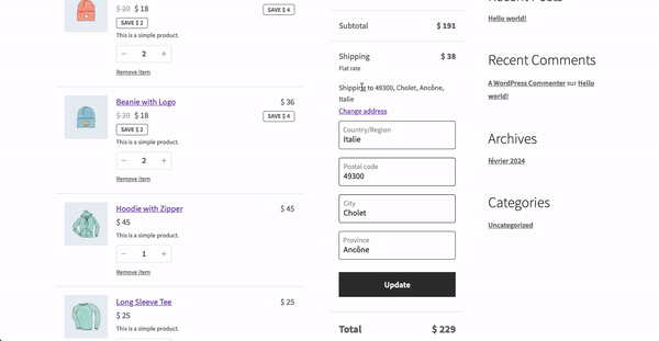

    It looks like you are using French as the language of your store, correct? I performed a test on my test site: I changed the language to French, and it seems to work as intended on my end; this is how it looks on my side:
    Image link: https://i.ibb.co/59PHnPF/sfdg.gif
