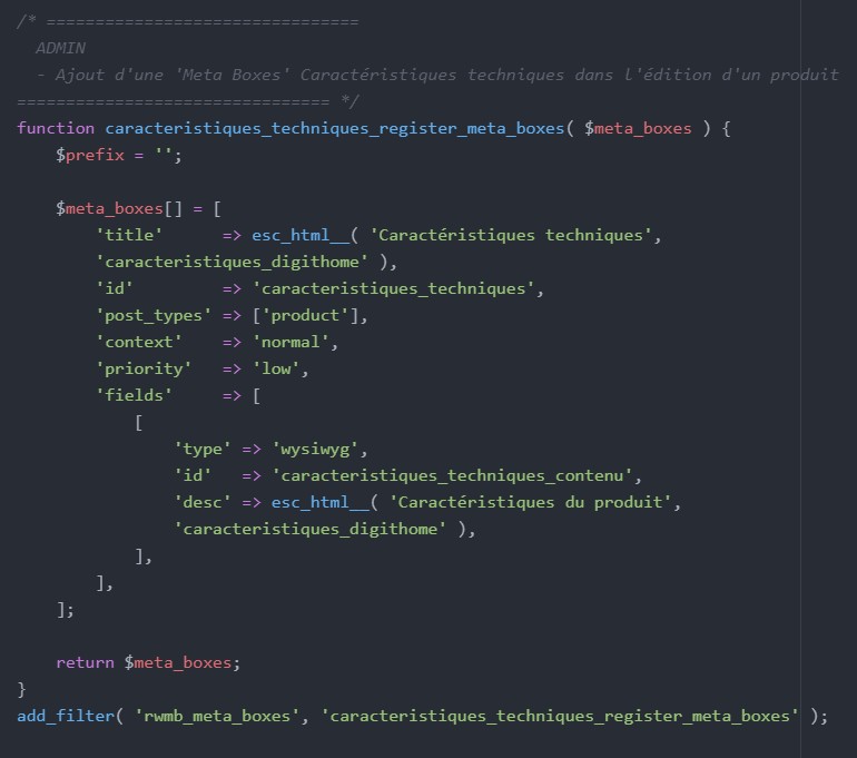

    1. I am using the Meta Box plugin to add custom WYSIWYG (TinyMCE) fields in the product editing section on my WordPress site.

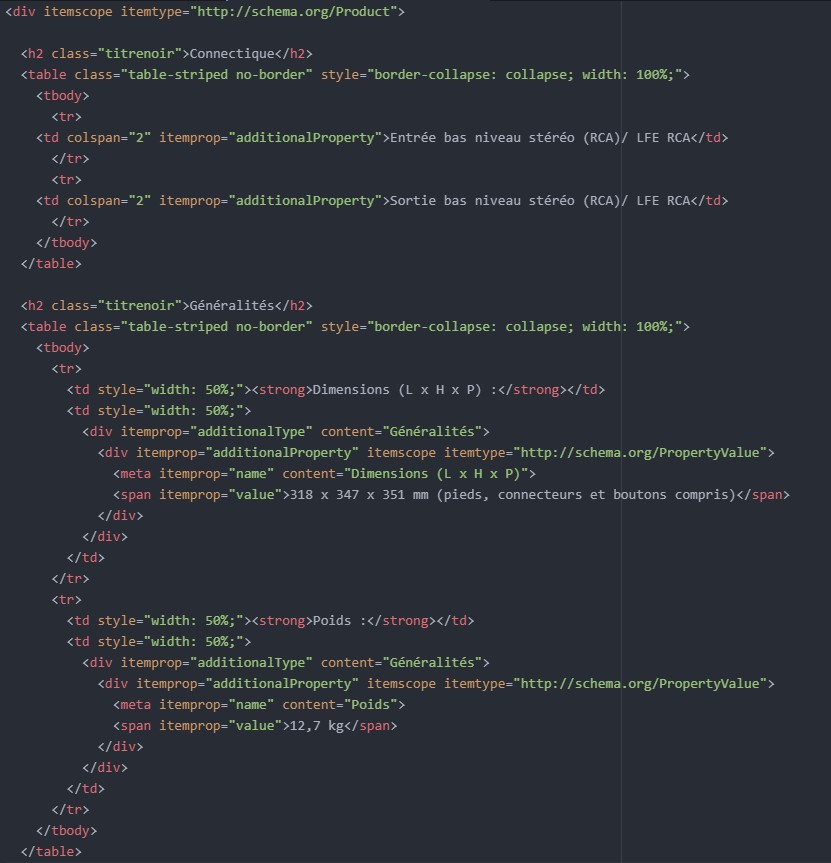

    2. I would like to retain certain microdata attributes (such as itemscope, itemtype, itemprop, itemid, itemref, and content) within these custom fields.
    3. I have tried extending the TinyMCE configuration by adding the valid_elements and extended_valid_elements options, but this did not work.
    4. I also tried registering a custom JavaScript file with the TinyMCE configuration and enqueuing it using wp_enqueue_script, but this did not solve the issue either.
    5. Despite my attempts, the microdata attributes are not retained when I save a product entry.
    Here is the code I am using to add the custom fields with Meta Box:
    https://i.postimg.cc/YqCxgC6s/help.jpg
    And here is an example of the HTML structure with microdata that I want to use:
    https://i.postimg.cc/WjWSLMsR/exemple.jpg
