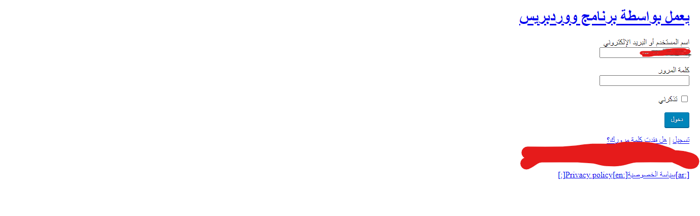

    My site seems to be working normally with all JS and CSS loading as expected in the main part of the website.
    However, in the /wp-admin (and wp-login) part of the website, the site appears something like this: https://i.ibb.co/yWffSqx/lb-error2.png
    As you can see, the CSS seems to not be working.
    I tried disabling the plugins one by one to no avail. I also tried deleting the content of functions.php in my theme to no avail aswell.
    I checked the network tab while logged-in to my wp-admin.php and found this: https://i.ibb.co/q1zZCnC/lbazar-error.png
    Upon further inspection I found that in fact these Javascript file seem to contain HTML code instead of Javascript code. I then went to the directory where these Javascript files are and their content is normal Javascript.
    How can I solve this problem of JS files (and CSS) loading with HTML code inside them instead of their actual JS (and CSS) contents, which is only happening in wp-admin and wp-login?

    I already had CONCATENATE_SCRIPTS set to false. Setting the other definitions hasn’t changed much.
    I noticed that in fact only script files loading from /wp-admin have this problem. Scripts from /wp-content or /wp-includes or others load normally.
    In that case , please take a complete backup of website setup, manually update WordPress 5.5.1 ( WordPress Core ) and then test it. Hope this helps to sort out the problem and fix the issues.
