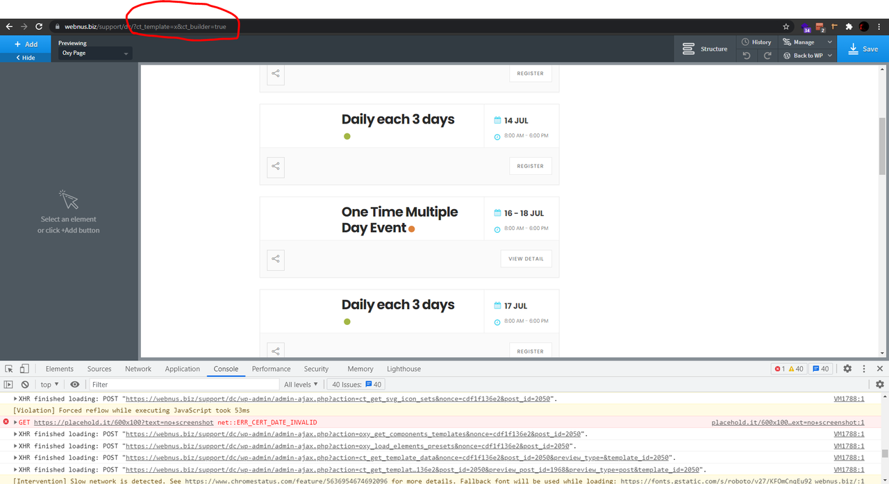

    Would you please check your issue in Oxygen Page Builder version 3.8?
    https://oxygenbuilder.com/2021/06/11/oxygen-3-8-now-available/
    Actually, I’ve checked your issue, and I didn’t see any issue on my end:
    https://i.postimg.cc/ZYynGH9d/image.png.
    Please keep us posted,
    Best Regards

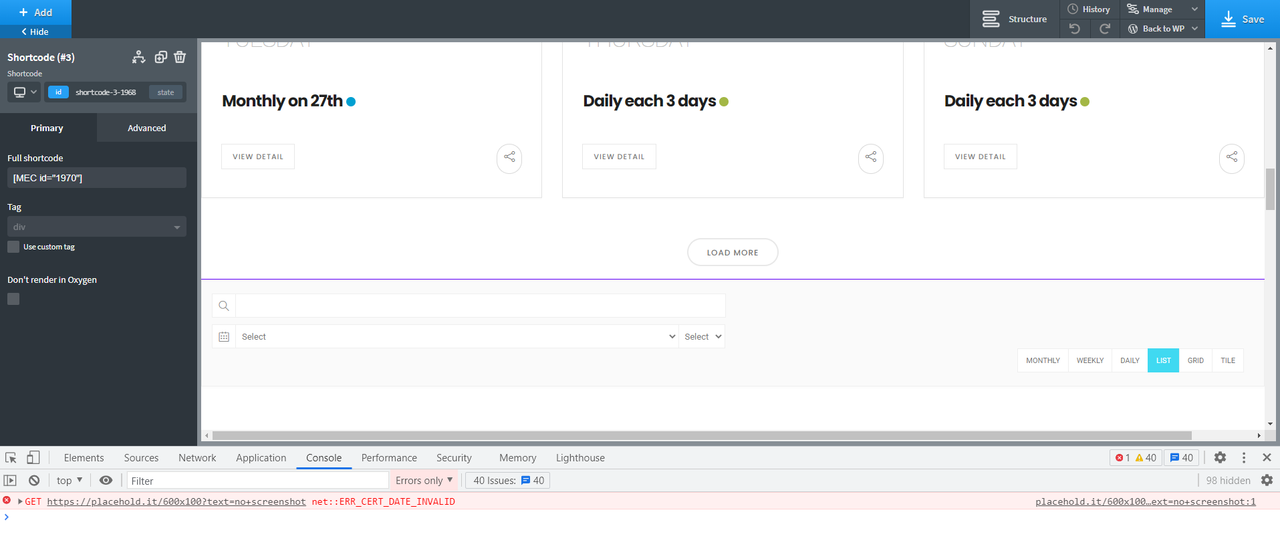

    Hello @janiebee83,
    The above link you have shared is a dashboard URL that I can not access without login details.
    To replicate the issue, I ask you to let us know which MEC shortcodes on the page you have?
    https://i.postimg.cc/YqXvs4RN/image.png
    Did you try to disable your plugins and enable them again and again to check your problem?
    We created different conditions but did not encounter any problems.
    Also, please install and activate this plugin: https://en-gb.ww.wp.xz.cn/plugins/enable-jquery-migrate-helper/. Then recheck your issue.
    Please let us know the result.
    Best Regards,
