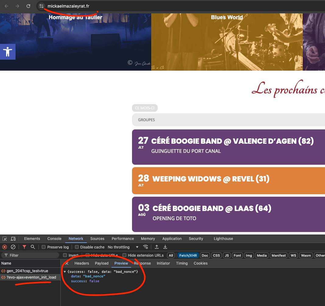

    The original error looks like this
    I manage to mask the code, by selecting the Search Engine Structured Data options, but the cards can’t be clicked anymore.

    So looks like the issue is caused because the initial ajax call is not returning the needed calendar data. We are not able to replicate this issue on our end. So would need to check close at your website from admin side to see whats going on. I am not really sure how we can do that. Perhaps we will dig more into this on our own side and see if we can catch anything.
