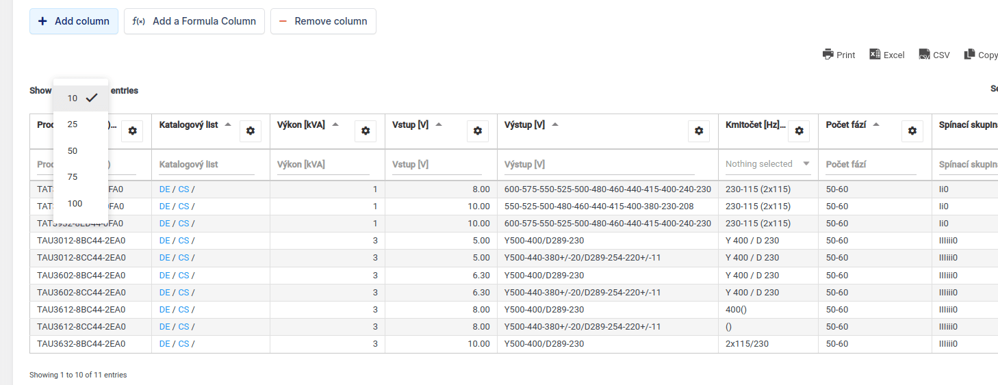

    This hook is not going to change the options in the back-end table settings/Display settings, here the options will look the same :
    But it will directly override the settings on the table itself,  ( in both back and front-end),
    so if we check on the table’s available options for number of rows,  it will then activate the hook’s settings in the “Show Number of Entries” dropdown :
    Of course, that was an example where we removed the “ALL” rows option,
    but you can modify the hook, to change/add options you need.
