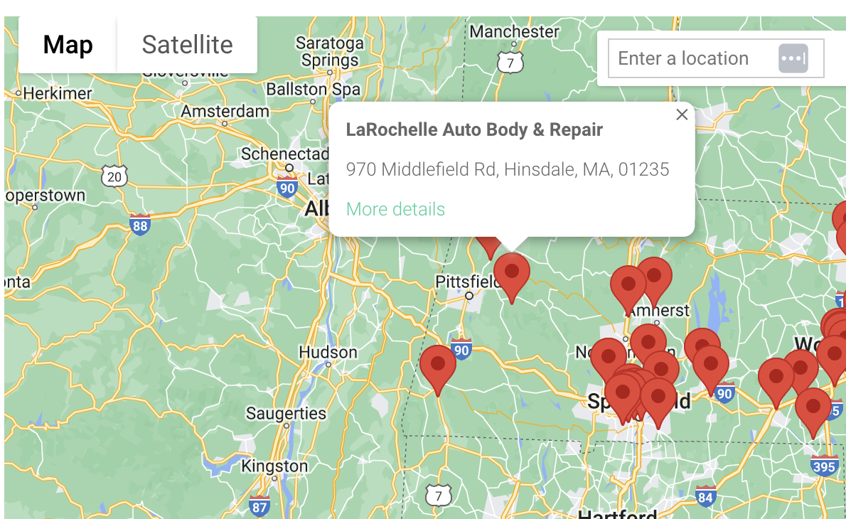

    There are no pins showing in GoMaps general settings, do not see ‘edit existing markers’ any tap in GoMaps.
    So, I guess that leaves with the possibility that Go Maps caches map data, please see image showing “LaRochelle Auto Body”, which has been deleted from the Connections data under; manage.

    I looked at the Go Maps code and saw nothing that stands out as a persistent cache.
    Are you using database object caching? This caches database query results. I think WP Rocket has that feature, as do many web hosts in their control panel.

    Thread Starter billenross
    (@billenross)
    OK, now I’m feeling really stupid, like REALLY stupid.
    I went into GoMaps, and now I see all the pins, I just deleted LaRochelle, and it was removed from map right away. I have no idea why I did not see this two days ago when you told me specifically what to look for.
    Now, I can just delete the pins I need to.
    Please forgive me for being so obtuse, all good now.
