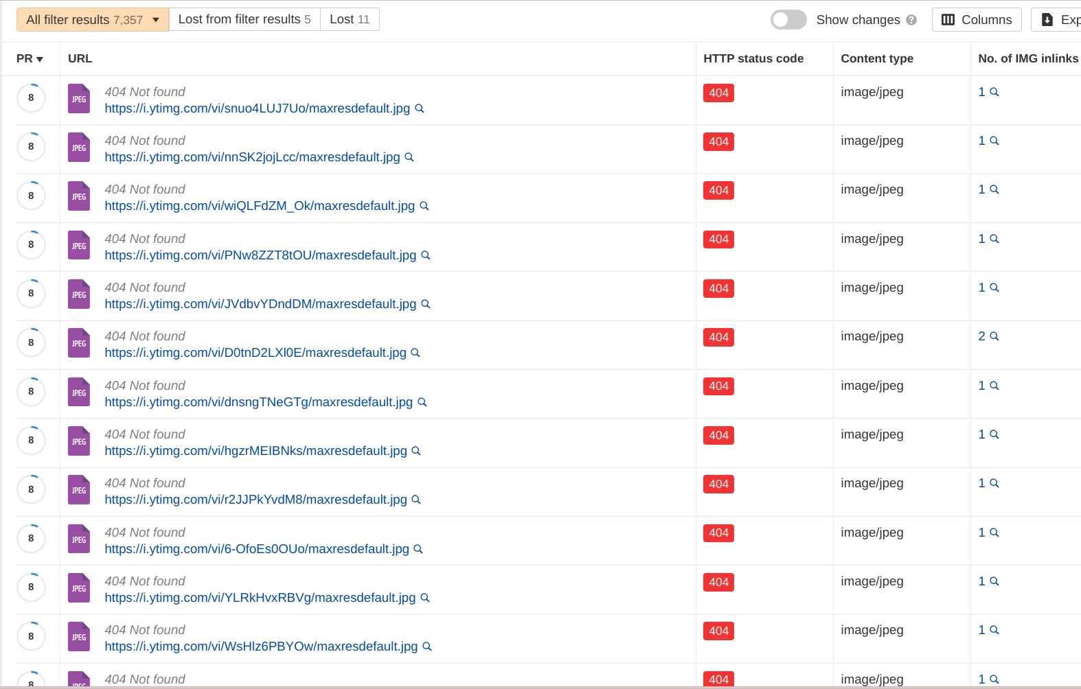

    I am getting over 7,000…yes, 7,000…404 errors on my site because of the maxresdefault error. The crawler can’t find the image, so it returns “broken image/broken link” errors. THIS NEEDS TO BE FIXED.

    Humm, maybe It’s all about Google’s URL Inspection – Mobile Usability tester on the Search Console. Google will download the page with little CSS (or just not use it), and then conform it responsively. Then you have the various elements one after another on a white background (for my site). As the images get bigger, it makes the text get smaller. This is a sample with a maxresdefault image – see how small the text is? That gets a mobility complaint from Google.
    When I change to hqdefault, that main b/w image you see gets considerable smaller, and then the responsive conforming displays the text relatively larger. So, I assume any very large image is going to skew the text size in this mobility tester. With hqdefault, all of the pages I’ve test are coming up OK for mobile. Hotfixed via change to youtube.php line 2872.
