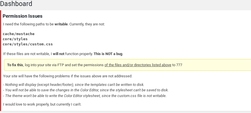

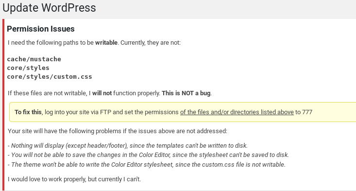

    I see this in the WordPress Dashboard:
    Permission Issues
    I need the following paths to be writable. Currently, they are not:
    cache/mustache
    core/styles
    core/styles/custom.css
    If these files are not writable, I will not function properly. This is NOT a bug.
    and yet:
    $ ls -la cache
    total 4
    drwxrwxrwx. 3 apache apache 19 Apr 4 23:41 .
    drwxr-xr-x. 9 apache apache 4096 Apr 5 17:29 ..
    drwxrwxrwx. 2 apache apache 6 Apr 4 23:41 styles
    $ ls -la core
    total 4
    drwxrwxrwx. 3 apache apache 19 Apr 4 22:03 .
    drwxrwxrwx. 2 apache apache 23 Apr 4 23:42 styles
    $ ls -la core/styles
    total 0
    drwxrwxrwx. 2 apache apache 23 Apr 4 23:42 .
    drwxrwxrwx. 3 apache apache 19 Apr 4 22:03 ..
    -rwxrwxrwx. 1 apache apache 0 Apr 4 23:42 custom.css
    somewhere else it was mentioned that PHP might be running under the wrong ID. But…

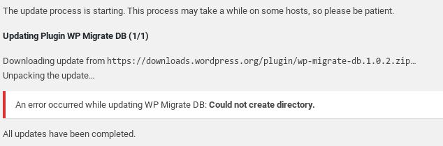

    I try to update WordPress via the GUI and get the following:
    Downloading update from https://downloads.wp.xz.cn/release/wordpress-4.9.5-no-content.zip…
    Unpacking the update…
    Could not create directory.
    Installation Failed

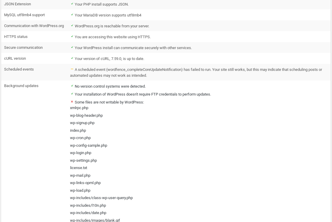

    In installed the “Healthcheck” plugin which yields the warnings:
    PHP Version 	7.1.8 - For performance and security reasons, we strongly recommend running PHP version 7.2 or higher.
    cURL version 	Your version of cURL, 7.29.0, is lower than the recommended minimum version of 7.38. Your site may experience connection problems with other services and ww.wp.xz.cn
    Scheduled events 	A scheduled event (tribe_aggregator_process_insert_records) has failed to run. Your site still works, but this may indicate that scheduling posts or automated updates may not work as intended.
    Your installation of WordPress doesn't require FTP credentials to perform updates.
        Some files are not writable by WordPress:
            xmlrpc.php
            wp-blog-header.php
            wp-signup.php
            index.php
            wp-cron.php
            wp-config-sample.php
            wp-login.php
            wp-settings.php
            license.txt
            wp-mail.php
            wp-links-opml.php
            wp-load.php
            wp-includes/class-wp-user-query.php
            wp-includes/l10n.php
            wp-includes/date.php
            wp-includes/images/blank.gif
            wp-includes/images/down_arrow.gif
            wp-includes/images/spinner.gif
            wp-includes/images/media/interactive.png
            wp-includes/images/media/default.png
    Those files above are absolutely writable by the apache user. As shown above, httpd and php are running as apache.

    Hi again, luminarycrush.
    As I look at the content of your screenshot, it says:
    “Downloading update from https:/’downloads.wp.xz.cn/release/wordpress-4.9.5-no-content.zip„.”
    That would indicate nothing was found to download.
    As I look at your warnings, I see:
    “cURL version Your version of cURL, 7.29.0, is lower than the recommended minimum version of 7.38. Your site may experience connection problems with other services and ww.wp.xz.cn”
    So the first thing I’d suggest is upgrading curl & let’s see where we are.

    Also, I attempt to upgrade a plugin and it doesn’t work:
    https://pangea-systems.com/jas/pub/share/misc/Screenshot%20from%202018-05-01%2011-44-12.png
    That’s the latest curl available in CentOS. I found a third-party repo which has a newer version. Now:
    $ curl --version
    curl 7.59.0 (x86_64-redhat-linux-gnu) libcurl/7.59.0 NSS/3.28.4 zlib/1.2.7 libpsl/0.7.0 (+libicu/50.1.2) libssh2/1.8.0 nghttp2/1.31.1
    Release-Date: 2018-03-14
    Protocols: dict file ftp ftps gopher http https imap imaps ldap ldaps pop3 pop3s rtsp scp sftp smb smbs smtp smtps telnet tftp
    Features: AsynchDNS IPv6 Largefile GSS-API Kerberos SPNEGO NTLM NTLM_WB SSL libz HTTP2 UnixSockets HTTPS-proxy PSL Metalink
    and
    https://pangea-systems.com/jas/pub/share/misc/Screenshot%20from%202018-05-01%2011-46-48.png
    Yet, same result.
    The issue is why is this happening:
    https://pangea-systems.com/jas/pub/share/misc/Screenshot%20from%202018-05-01%2011-50-55.png
    luminarycrush, let’s try disabling SELinux & then updating to see if that has any effect. When I try to download WordPress it gives me a filename of 4.95.zip, but for now let’s just try disabling SELinux & see where we are w/that.
