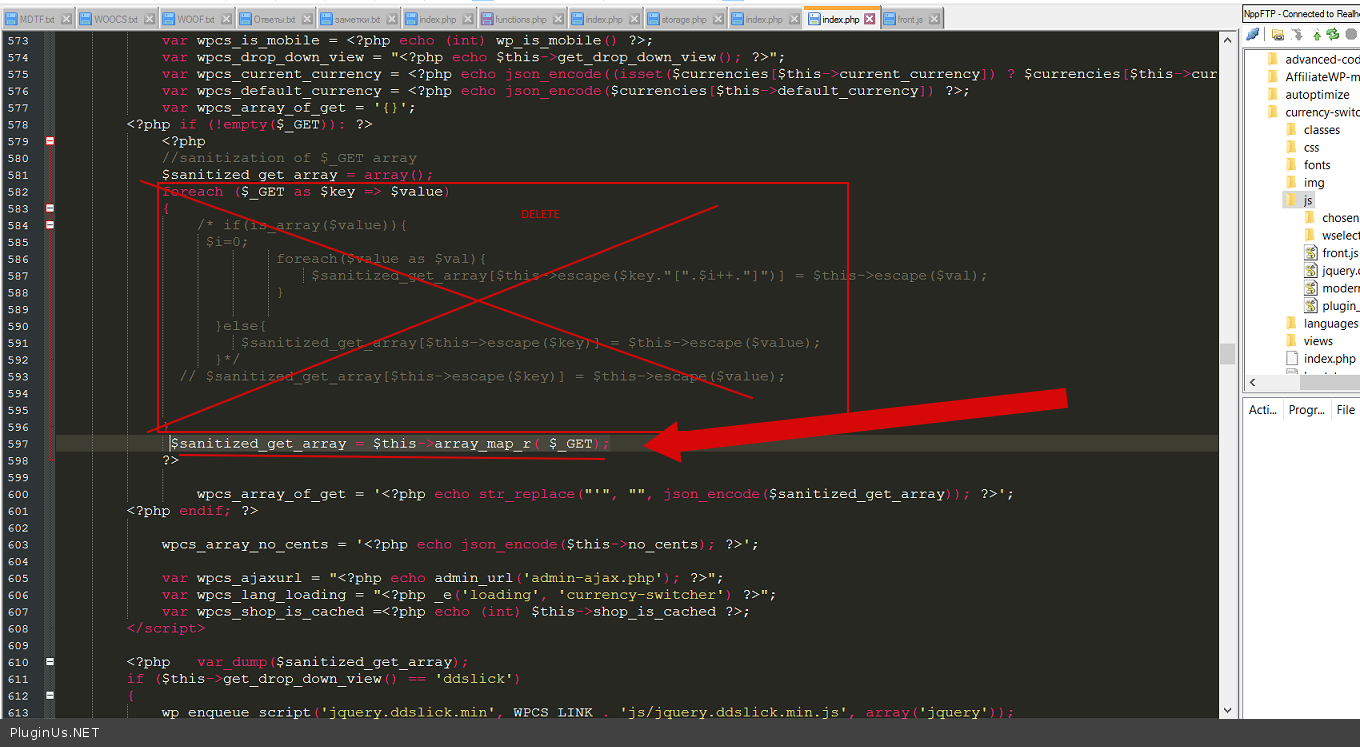

    In file index.php paste code( http://c2n.me/3IksKXN.png ) – $sanitized_get_array = $this->array_map_r( $_GET);
    Add function –
     function array_map_r( $arr )
    		$newArr = array();
    		foreach( $arr as $key => $value )
    			$newArr[$this->escape($key) ] = ( is_array( $value ) )? $this->array_map_r( $value ) : $this->escape($value )  ;
    		return $newArr;

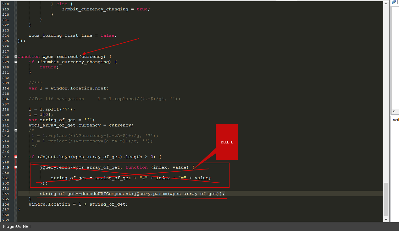

    In file – \plugins\currency-switcher\js\front.js paste this code ( http://c2n.me/3IkvIrB.png ) :
    string_of_get+=decodeURIComponent(jQuery.param(wpcs_array_of_get));
    Please do test.

    Hello
    Add this function In file \plugins\currency-switcher\index.php – http://clip2net.com/s/3Ip6CM2
    In file – \plugins\currency-switcher\js\front.js – http://clip2net.com/s/3Ip5l7v
    In file \plugins\currency-switcher\index.php $sanitized_get_array = $this->array_map_r( $_GET);

    As far as I can see, this is working properly now. Th URL stays the way it is supposed to stay after currency is changed.
    Thank you very much!
