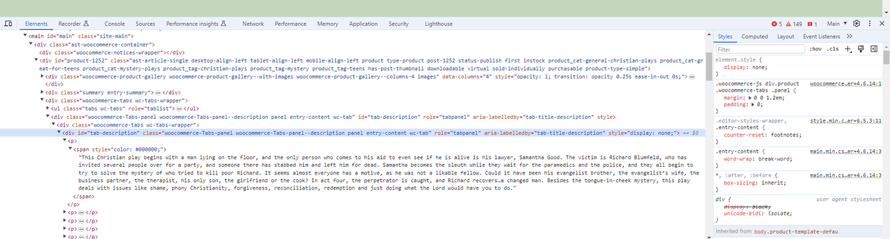

    seank123
    (@seank123)
    It’s your theme – you’ve got a line in the code that is adding a display:none CSS line to that tab
    https://i.postimg.cc/5Ng3kgtb/wc-001.png

    Hello again @scriptsbywarren HostGator is really bad at giving advice. We don’t have a design team. This is pretty much it for support. This forum. A group of volunteers.
    But @seank123 is correct. You have a setting on that element that is hiding it. I’m not able to catch it and I’m not sure how they did, but his screenshot is clear. So you either have a setting in your theme that says enable or disable Single Product Description or an app that is doing it. You need to review all your settings.
