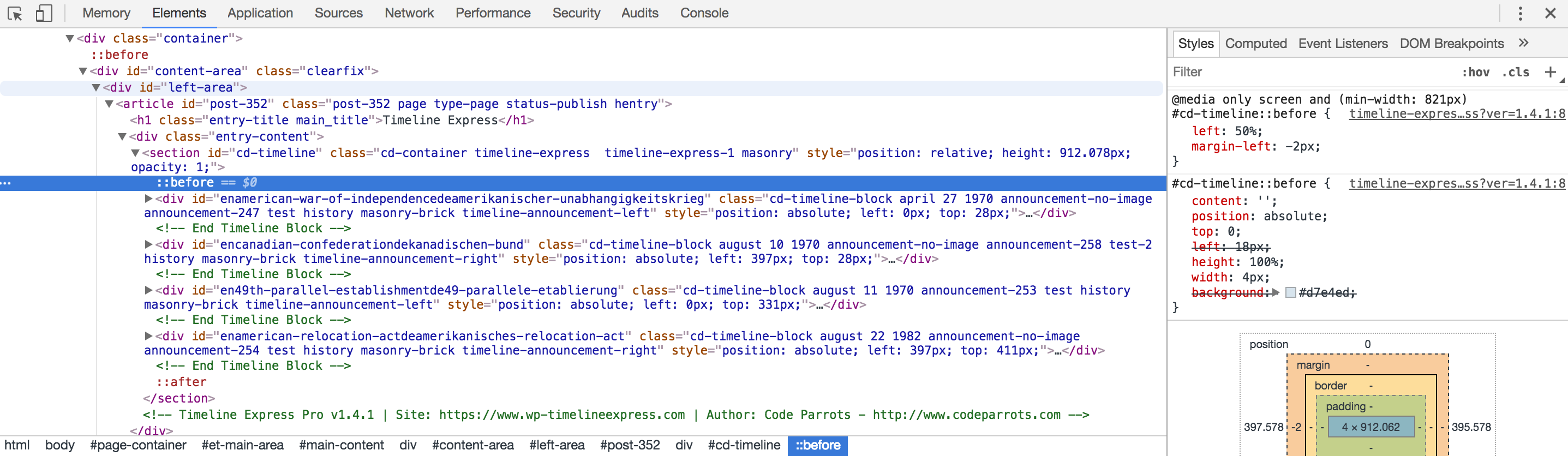

    If you right click on the timeline and select ‘Inspect Element’ and then view the “Elements” tab of the console (This is in Chrome, your browser may differ), then locate the element <section id="cd-timeline", expand it and click the :before element nested beneath it, you should be able to view the CSS styles associated with the line running down the background.
    Here is an example:
    https://cldup.com/C7lOYzKPjT.png
    You can see on the right-hand side the styles. Can you share a screenshot of yours or let us know what the styles are?

    I believe this is what you need. Correct me if I am incorrect then I can upload a screenshot.
    #cd-timeline::before {
    background: #000000;
    @media only screen and (min-width: 822px)
    timeline-expres…ss?ver=1.4.4:8
    left: 50%;
    margin-left: -2px;
    content: ”;
    position: absolute;
    top: 0;
    left: 18px;
    height: 100%;
    width: 4px;
    background: rgba(179,177,179,.75);
    style.css?ver=1.0.4:105
    div:before, article:before, aside:before, details:before, figcaption:before, figure:before, footer:before, header:before, hgroup:before, menu:before, nav:before, section:before, div:after, ul:after, article:after, aside:after, details:after, figcaption:after, figure:after, footer:after, header:after, hgroup:after, menu:after, nav:after, section:after {
    content: “”;
    display: table;
    style.css?ver=1.0.4:46
    *:before, *:after {
    -webkit-box-sizing: border-box;
    -moz-box-sizing: border-box;
    Plugin Contributor Code Parrots
    (@codeparrots)
    It looks like the second part:
       content: “”;
       display: table;
    is what is throwing things off. Our styles look correct. It’s also possible the border-box; box sizing attr is doing it. Can you try checking/unchecking the styles for those to see if anything changes in your browser?
