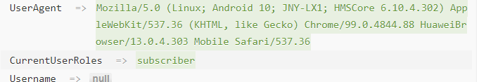

    Sure this is start happening where is last update releases.
    Here is examples most users show how use Andorid 10 K on some users show correct but 80% is incorrect
    This is how show incorect example i check other users, and test from my two mobile android 13 and android 8 and show like this https://i.postimg.cc/mrt15nFf/android10k.png
    This is one of correct show
    https://i.postimg.cc/mkXGJmHJ/correct.png
    I am not change anything only this plugin is updated.
