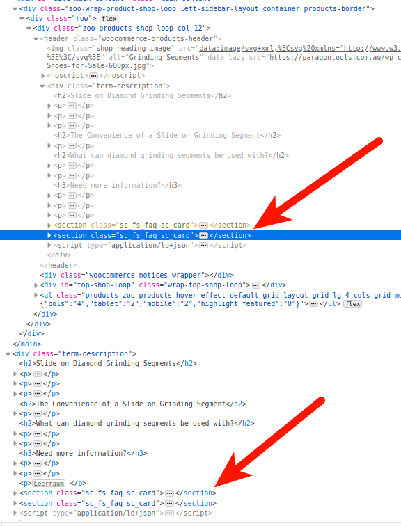

    Plugin Author Gordon Böhme
    (@gorbo)
    Hi @zoe84 ,
    now I have found the problem: the plugin has no error but your theme!
    All your content is output twice in source code – here you have to rework the integration of woocommerce in your theme.
    The duplicate content in the product header is only hidden by CSS
    header.woocommerce-products-header {
        display: none !important;
    Greetings
    Gordon
    (@gorbo)
    Hi @zoe84 ,
    i think you should contact the woocommerce integrator or the guy/girl who set up the whole website.
    Give him/her the information above and send also the following screenshot: https://wpsc-plugin.com/wp-content/uploads/sites/2/Auswahl_237.png
    Greetings, Gordon
