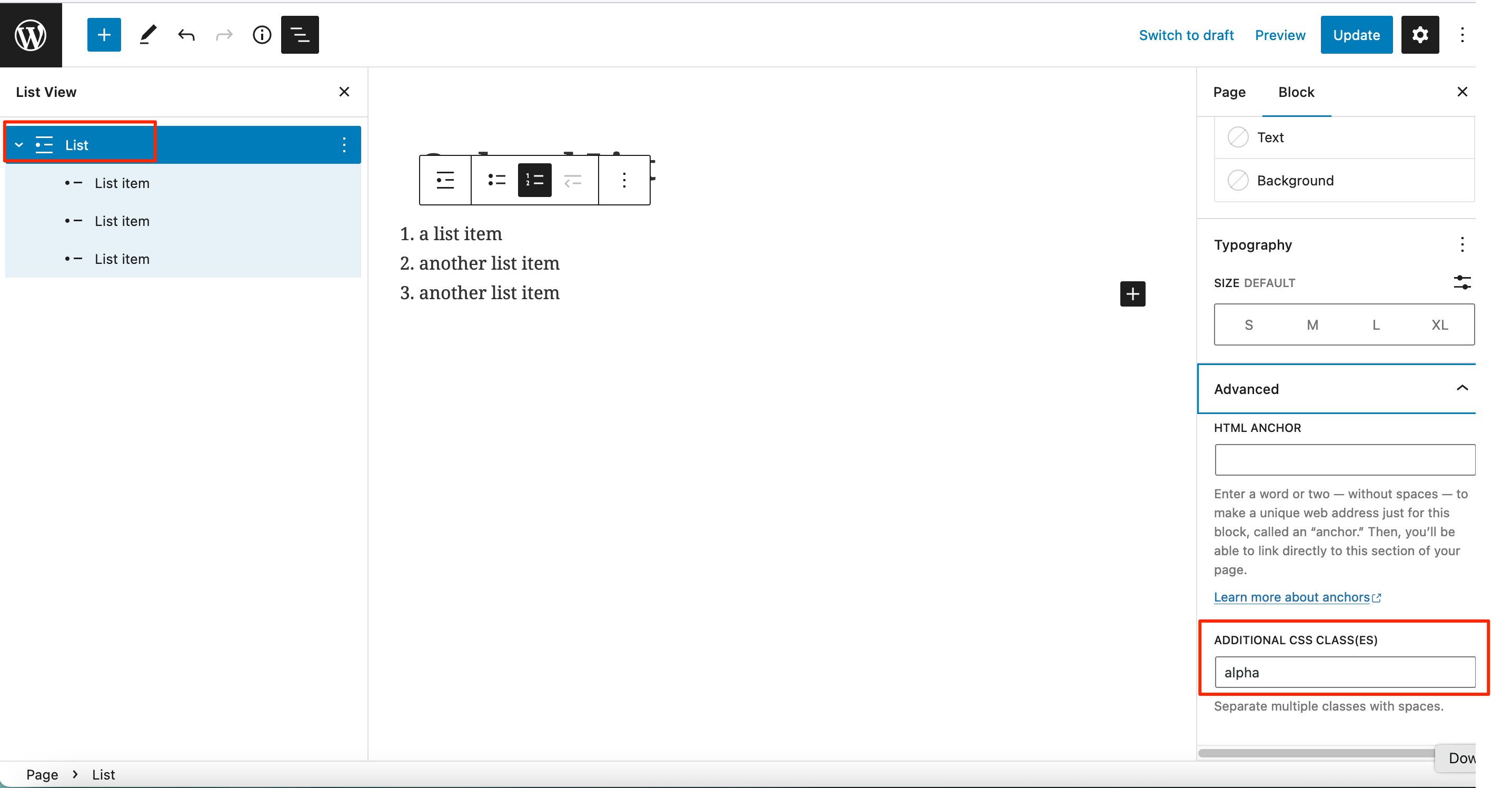

    If you’re using a List block, add a custom class to the ones you’d like to be alphabetical, such as alpha.
    Then, add the following under Appearance > Customize > Additional CSS:
