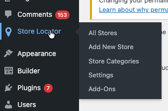

    Thanks for your quick response. I flushed the Permalinks with no success as the link is still not working when I click on “Store Locator” along the left side.
    I am able to see both “Add New Store” and also “All Stores” along the left side. The Add New Store link works, but not the All Stores. https://madshot.net/8cb46725deaa.png
    Hi @paulrichardsonmadwire,
    Thanks for the update and the screenshot. Since flushing permalinks didn’t work and the menu items are visible but lead to a ‘not found’ page, we can rule out standard URL routing issues. This points to a conflict during the Custom Post Type registration in the backend.
