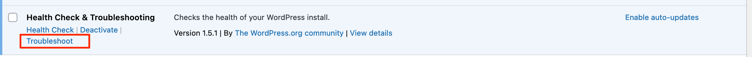

    Hi @cfm168 – when you click the Troubleshooting link that looks like this:
    …could you please provide a screenshot of the page you arrive at?

    Moderator Kathryn Presner
    (@zoonini)
    OK great! So what the plugin does is temporarily deactivate your plugins. When you look at the Plugins page in Troubleshooting mode, you should see no plugins active except for Health Check.
    While in this mode, check the areas of your site where you were seeing those PHP errors earlier to see if they are still present or not.
    If they are no longer present, activate your plugins one-by-one while still in Troubleshooting mode. Recheck your site in between each reactivation to see if the errors come back. If they come back, then you know the problem is with the last plugin you reactivated.
    Once you’ve found the culprit, you can turn off Troubleshooting mode.
    There’s a full guide here on how to do this as well.
    Let me know how it goes!
