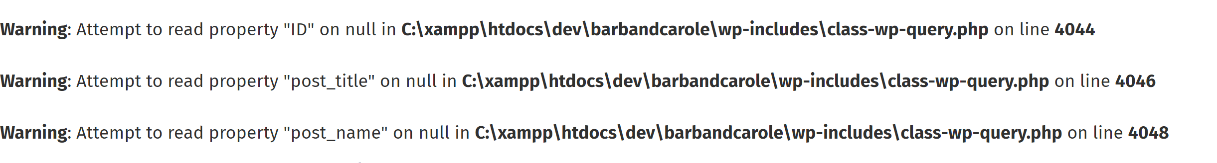

    Thread Starter Nazrinn
    (@nazrinn)
    I did as indicated and now I’m getting these 3 warnings. These are definitely caused by WPACU, as the warnings go away when I deactivate the plugin.
    This seems to happens only on the homepage, too.
    • This reply was modified 4 years, 11 months ago by Nazrinn.

    Plugin Author Gabe Livan
    (@gabelivan)
    @oldrup sorry about that! At least it doesn’t show on a live website (anyone should have switched off printing these warnings unless it’s a staging/dev website). If you delete the plugin and re-install it (all settings would be preserved), you should not have these warnings anymore!
    @nazrinn are you sure the problem is from Asset CleanUp? The warnings seem unrelated to the plugin.
