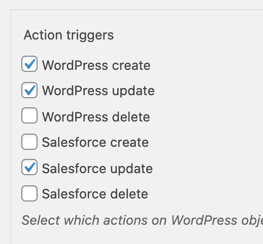

    Your log entry, for example, does not mention whether the plugin made a SOQL query to get updated records. Your fieldmap might be configured incorrectly. For example, if you don’t have Salesforce Update as a checked option (as in this image.
    If it’s not that, there’s not much I can do. But if the plugin is working properly, when you have Debug mode enabled you’ll see a lot of log entries that, if you click on the title to get details, will include SOQL requests to load data from Salesforce.
