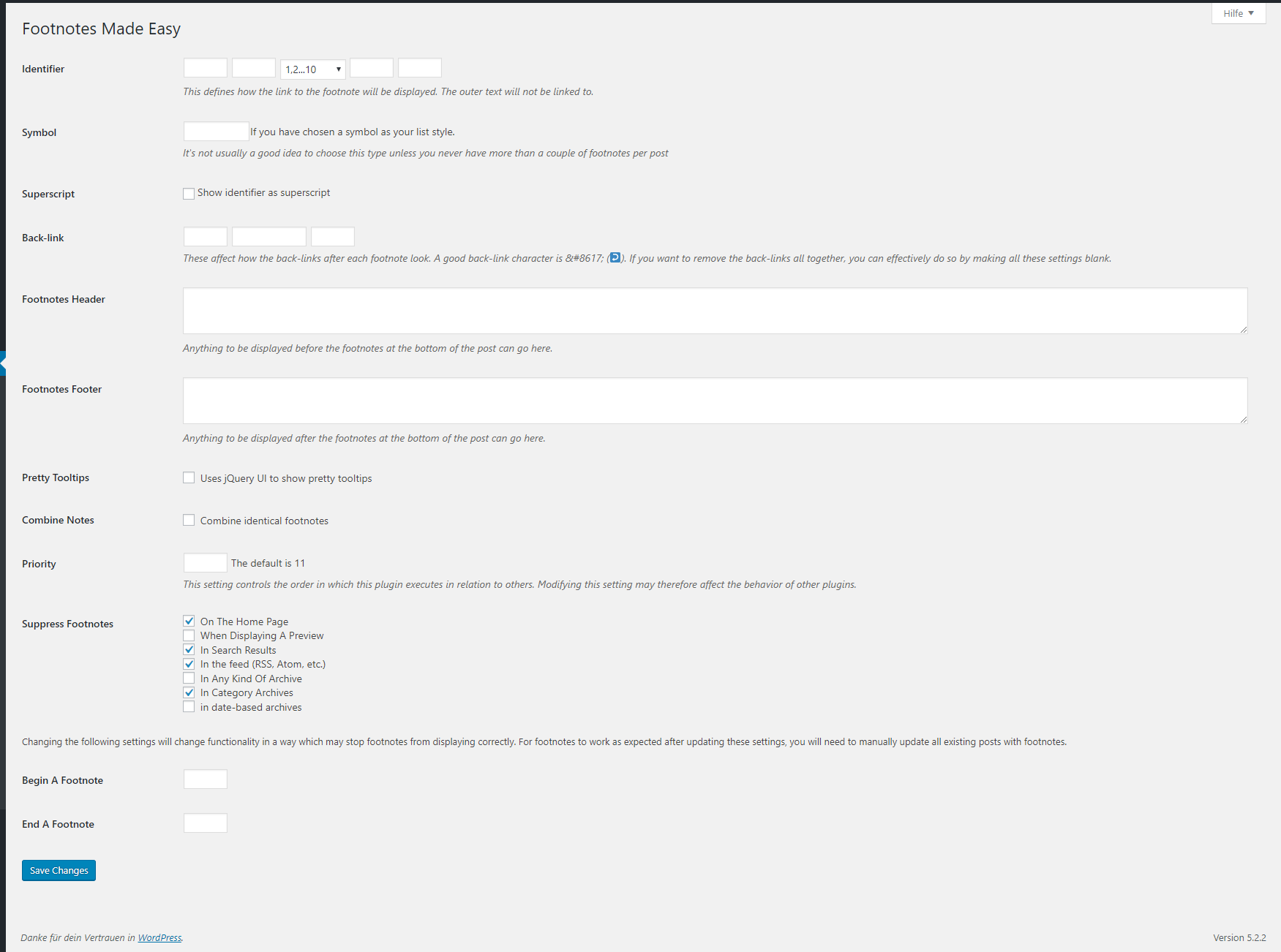

    Can you provide me with a screenshot of your Footnotes settings screen? That would really help.
    Plugin Contributor David Artiss
    (@dartiss)
    Ah, I see – most of your options are still blank and that will be causing the issue. Make sure you fill in all the settings, save and the error should go.
