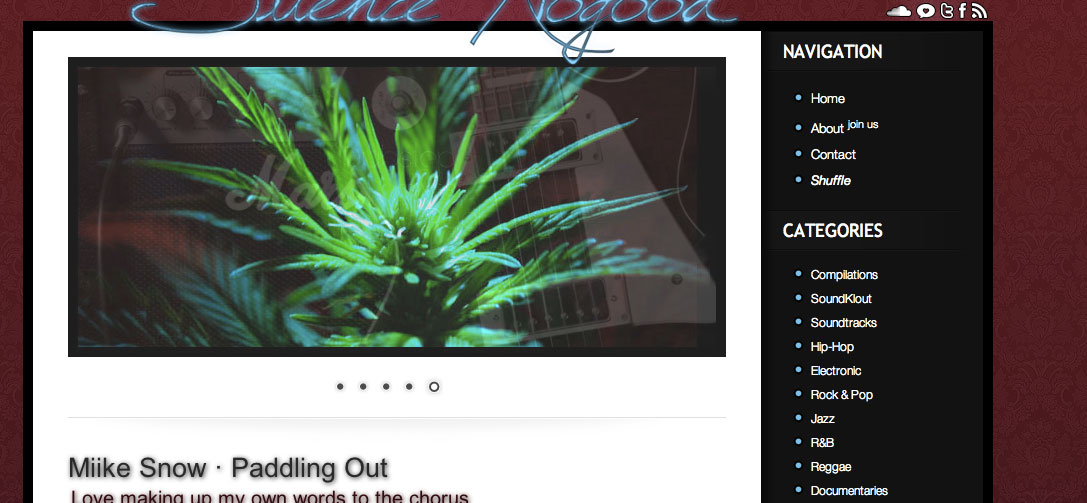

    It’s still doing it for me. I’m using Chrome & Firefox on my Mac. I’ll give you some screenshots.
    The “Video Game Dubstep Remixes” image always loads before the slider, slightly off to the right (you can see it’s not center)
    http://silencenogood.net/images/Meteor-1.jpg
    Then the actual slider loads and centers up.
    http://silencenogood.net/images/Meteor-2.jpg
    Is there a reason that image loads first (off to the right) and then skips to the first random image?
    I also use your slider on my other site and I don’t seem to have this problem. http://zech.mn
    Thanks again for the help 😀
    Plugin Author Josh Leuze
    (@jleuze)
    Ah, I think I know what is going on. The stylesheet for the slideshow is setup to hide all but the first slide until the slideshow script kicks in and takes over the visibility of the slides.
