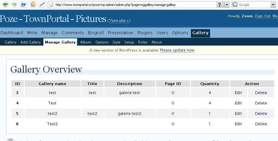

    * As for the other problem here is a link to show you what is happening:
    http://www.townportal.ro/pictures/_NGG.JPG
    Whenever I make a new gallery, it’s doubled somehow. Not very bothering, but still…

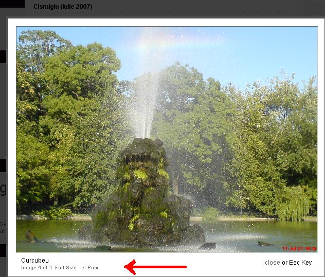

    Sorry for the triple post, but testing it frther showed me a new error:
    picture with error
    There is no next button after the 4th pic. (In my case 4, because I wanted to show only 4, but I suspect it’s the same for each number)…
