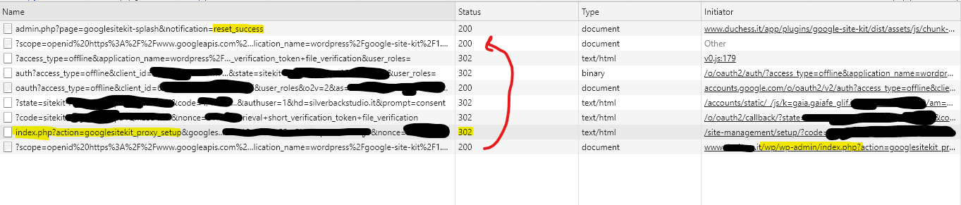

    Yere you can find the URL redirect chain: IMAGE, the return url
    /wp/wp-admin/index.php?action=googlesitekit_proxy_setup&googlesitekit_code=sitekit-AAA&googlesitekit_site_code=AAA&nonce=AAA
    is correct and the response has the X-Redirected-By: WordPress header.
    I’ve inspected the SiteKit plugin code: seems that if WP fails to authenticate to SiteKit it blindly redirects to OAuth flow, maybe assuming that some scopes are missing or revoked. To let the user better troubleshoot I suggest adding an error notice and a retry button..
    The reason why the auth if failing is still unknown to me.
