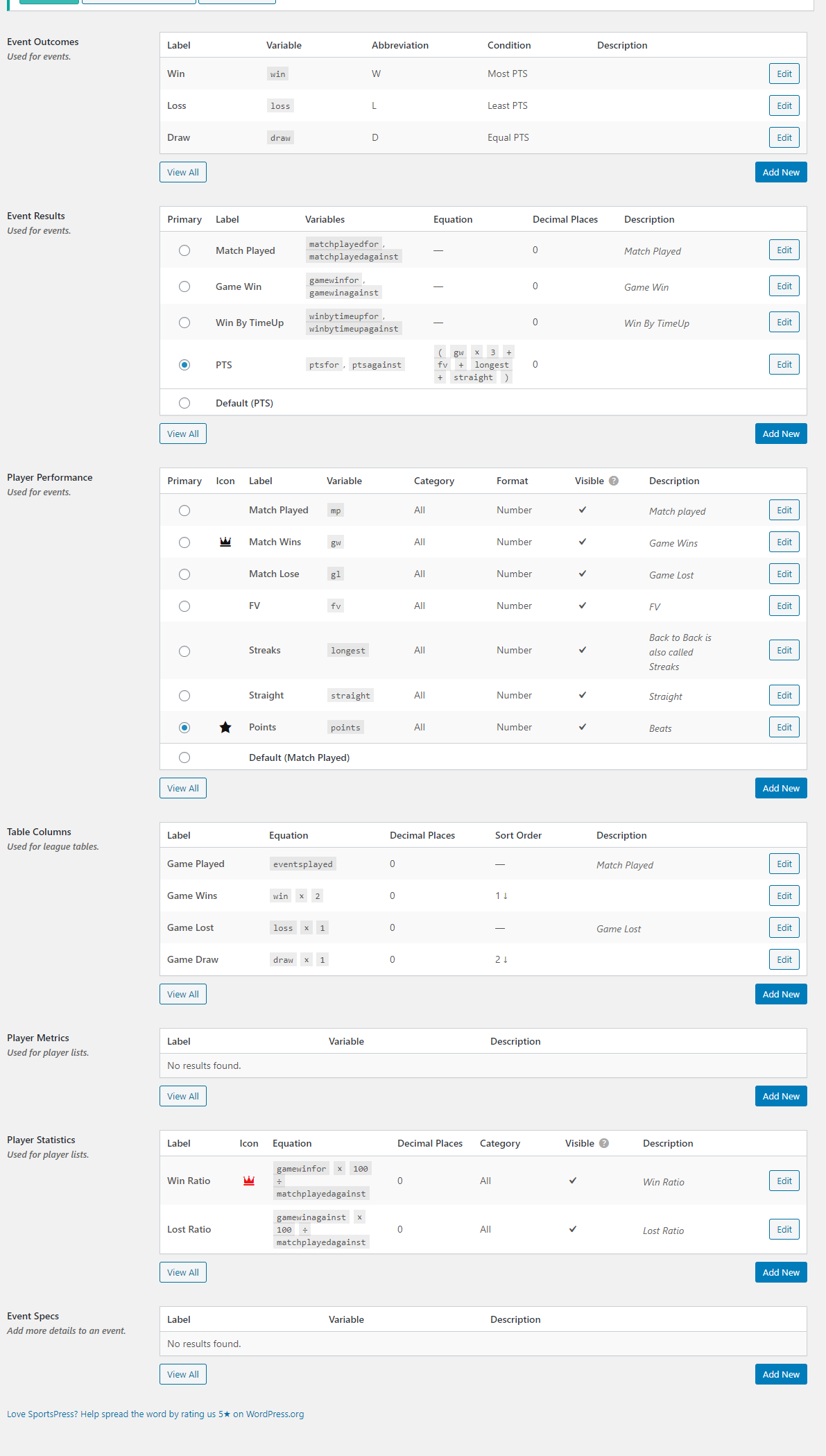

    roko123, this depends on your column indeed. What do you have under SportsPress > Configure for that column?
    Thread Starter roko123
    (@roko123)
    screenshot link
    Link

    I have added Points in Event Results table with the name PTS, Points and PTS is same

    If I were to guess I’d say that this is a setup issue. You have PTS and points, one is event results and the other is player performance. But these aren’t the same thing (each has its own field)

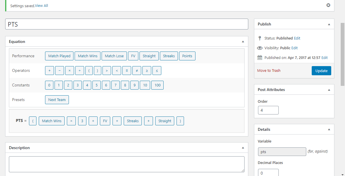

    below link PTS and Points formula
    PTS
    Points

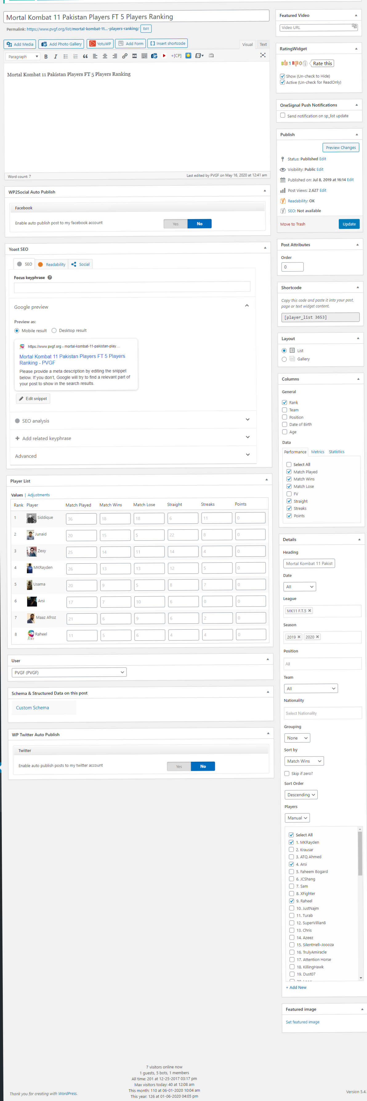

    Page setting
    Hi there!
    I’m sorry for the delay and thanks for the screenshot.
    I didn’t know that it was a player list. Alright. Are you using this one:
    http://prntscr.com/sy5b9p
    If yes these are displayed only in your events. For an actual points formula you need it as a stat.
    If you do have a stat for it, please double check the formula, if it is using the PTS variable it won’t work, you need to use only nunmber-based variables (such as game wins, straight and others)

    thanks that i know PTS column will show only in events but i put points Player Performance Used for events. and i used number and this points setting that is same setting for Straight,Streak,game wins and that perfectly only points not showing
