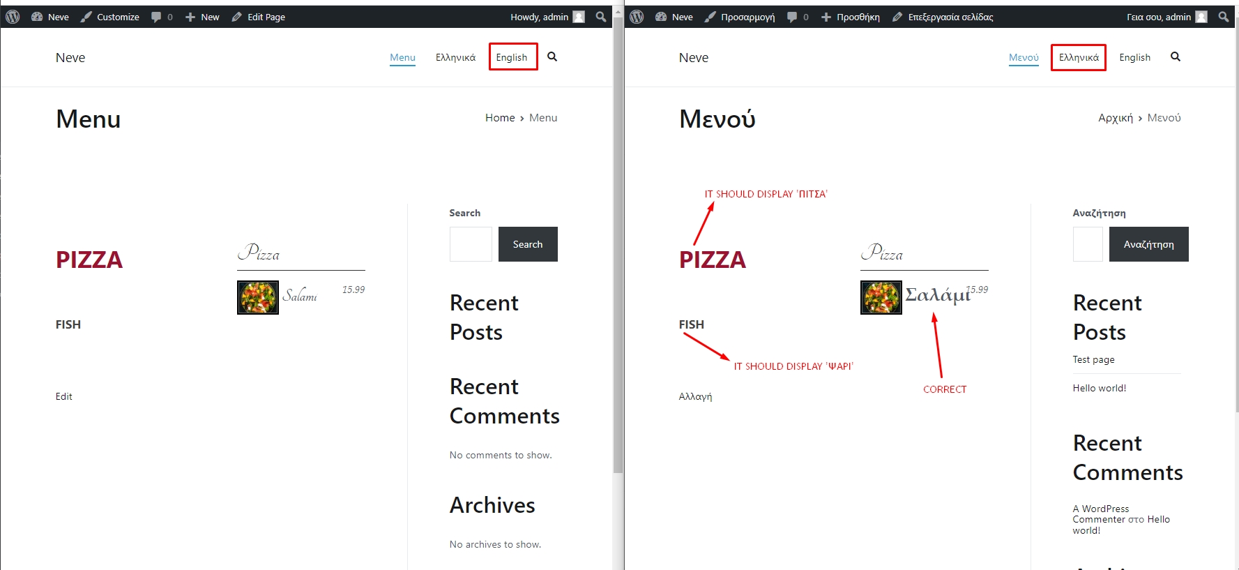

    While I agree that people have no reason to visit any taxonomy pages, this issue does affect the way the section is displayed on the front end. While all the items in your dedicated menu page (containing the shortcode) will be displayed in the correct language, the menu section that a user clicks to scroll on the desired section is being displayed in the wrong language.
    Related screenshot with the said issue: https://i.ibb.co/XsXWrYg/Screenshot-1.jpg
    Polylang includes an option for ‘Custom post types and Taxonomies’ but it is deactivated. In order to activate it the theme/plugin must use the same actions and filters as WordPress. I don’t know if this is the case with the Five Star Restaurant plugin. More info at this link: https://polylang.pro/doc/multilingual-custom-post-types-and-taxonomies/

    Does Polylang provide a way to search for and translate specific strings (like WPML’s string translation extension)? Perhaps you can search for Fish (and any other section names) that way and translate all instances that you find.
    Thread Starter Chris.V
    (@chrisv234)
    Unfortunately in the free version, Polylang, does not offer a way to search and translate those specific strings. For now I will go with my workaround. Thanks for the fast reply!
