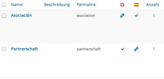

    I need polylang for wp-testing plugin because the site is integrated. the website will be available in “de” and “es”, so when you’re on the test site and switch the language button, the test should also switch to the other language. I translated the test-categories as you can see in this screenshot, but i can’t translate the results, the scales and the answers (there is no language sign like in the test-categories)

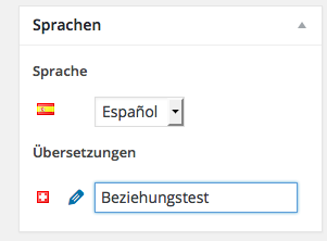

    I already have the switcher, that’s not the case. It’s the translation-connection between the german and spanish test. I can see in you’re screenshot it works, but when i add the ES test as translation to my DE-test (or the reverse) and click on “Safe” it doesn’t Safe: the translated field gets empty.
    I’ll show it to you with screenshots.
    First i’m going into the spanish test and choose the translated german test as translation:http://fs2.directupload.net/images/150706/jmtayrno.png
    Then i go to “Safe” – and it’s gone: http://fs2.directupload.net/images/150706/u73immyl.png
    It doesn’t keep the translation and I have no idea why this happens.
